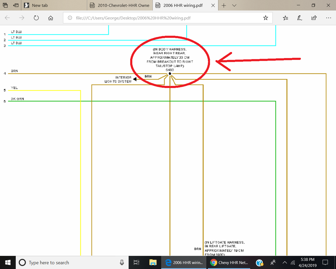

I think what bothers me the most is this is just the fact that it works, then it doesn't, then it works, then it doesn't. I understand that the L and R tail/brake lights are on different circuits so I'm only dealing with the drivers side rear.
I agree that this sounds like a broken wire, but where? My last resistant check from the bulb socket to just behind the rear door checked good. I will admit that I'm perplexed but I'm not beaten.

If this is a single tail light not working, a broken wire would have to be close to the socket. By the wiring diagram, all the tail light brown wires connect together close to the rear sockets. For just one to go out the break would have to be between that junction and the socket.
Check that area but I'll also suggest rechecking the ground, socket and even the bulb.
