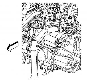

I will assume then that the DTC was P0128 (Engine Coolant Temperature (ECT) Below Thermostat Regulating Temperature). Replacing the thermostat is the usual repair for this code.
2007 Chevrolet HHR | HHR (VIN A) Service Manual | Document ID: 1833247
Engine Coolant Thermostat Replacement:
Removal Procedure
Drain the cooling system.
Reposition the radiator outlet hose clamp at the thermostat housing.
Remove the radiator outlet hose from the thermostat housing.
Name:  stat 24l 1.jpg

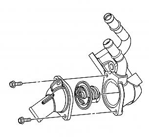

Remove the thermostat housing cover bolts and cover.
Remove the thermostat.
Remove and discard the thermostat housing O-ring seal.
Installation Procedure
Name:  stat 24l 2.jpg
Install a NEW thermostat housing cover O-ring seal.
Install the thermostat.
Install the thermostat housing cover bolts.
Tighten
Tighten the bolts to 10 N·m (89 lb in).
Install the radiator outlet hose to the thermostat housing.
Position the radiator outlet hose clamp at the thermostat housing.
Fill the cooling system.
