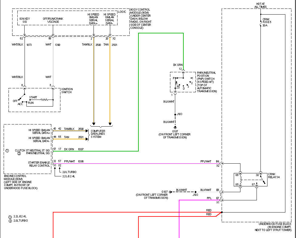

Crank relay #34 under hood?
Most of what we used to call switches are now "position sensors". Now that everything is digital the sensors are analog?

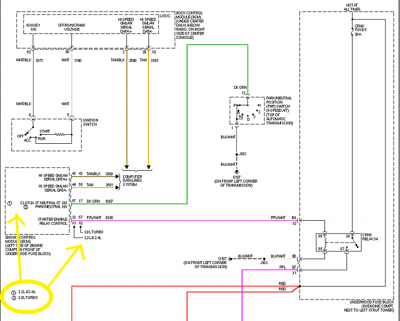

Old Dec 27, 2016 | 06:14 PM
Posts: 11,721
Hey Don. Could you decipher the diagram notes I circled in yellow ? I can't seem to figure them out.

Old Dec 27, 2016 | 07:23 PM
Posts: 26,533
X denotes a connector, they are different between 2.0 and 2.2/2.4
Same wire serves neutral sensor on Auto and clutch sensor on 5 speed. I think they meant A/T and 5 spd.
The 2 red wires go to starter and charger. The ppl wire goes to the solenoid. Bothe the motor and the solenoid are grounded.

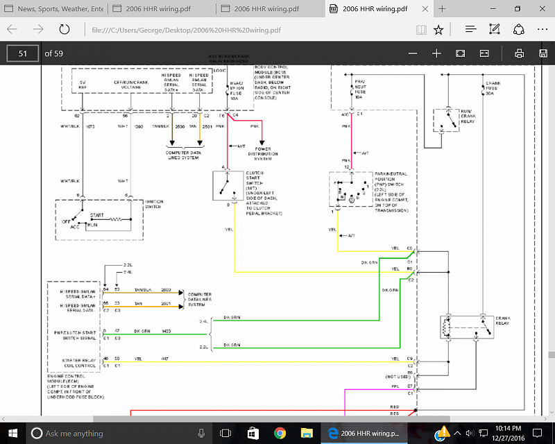

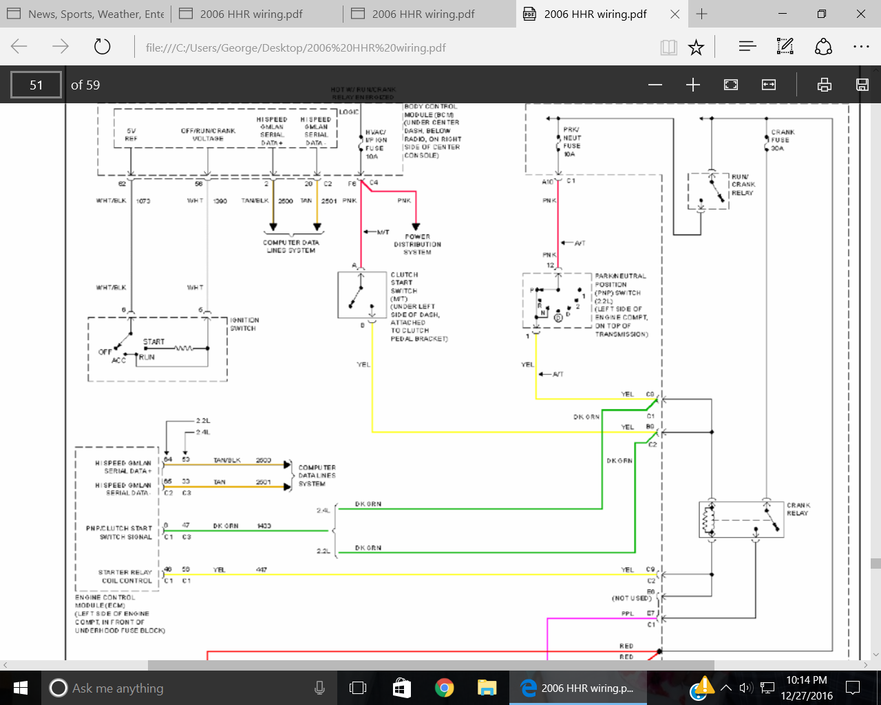

Old Dec 27, 2016 | 10:26 PM
Posts: 11,721
Thanks Don.
I guess I was confused because I didn't see a separate circuit for the clutch pedal position sensor.
Here's a little different diagram from a 2006 HHR wiring file.
