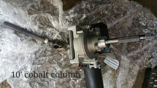

My eBay column from a 2010 cobalt.

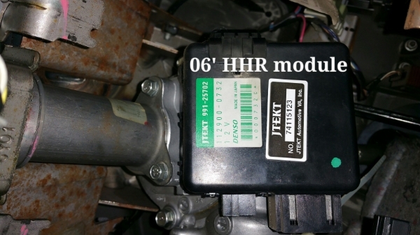

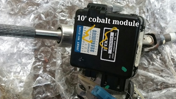

The cobalt module numbers
The numbers on my current module

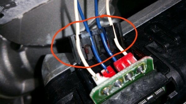

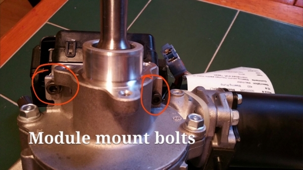

Here is the location of the two mounting bolts to remove the module from the column.

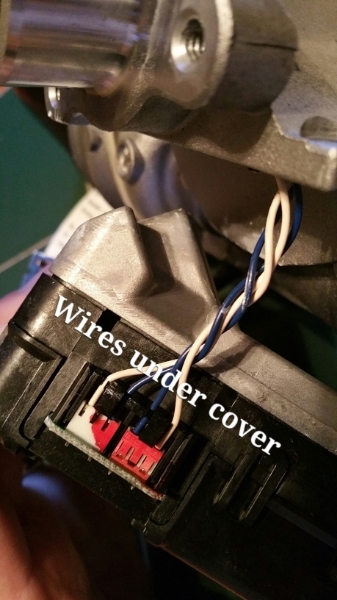

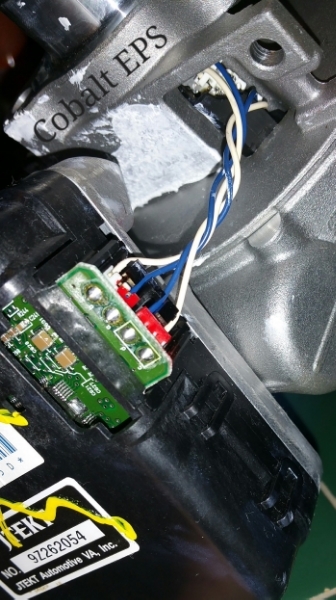

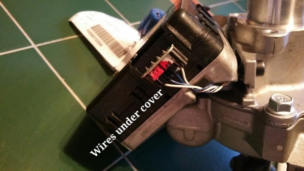

Here are the wires that are under a plastic cover on the Bach side of the module that run into the column.

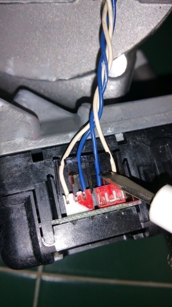

The plastic clip I removed to attempt removing the red and white connectors.
And the two little connectors that halted it all for the evening. ..

I did find that those wire connections do not come off, a guy at work actually broke them trying. Luckily he is a computer guy so he is going to resolder them for me and I'm going to install the complete unit not just the module.
