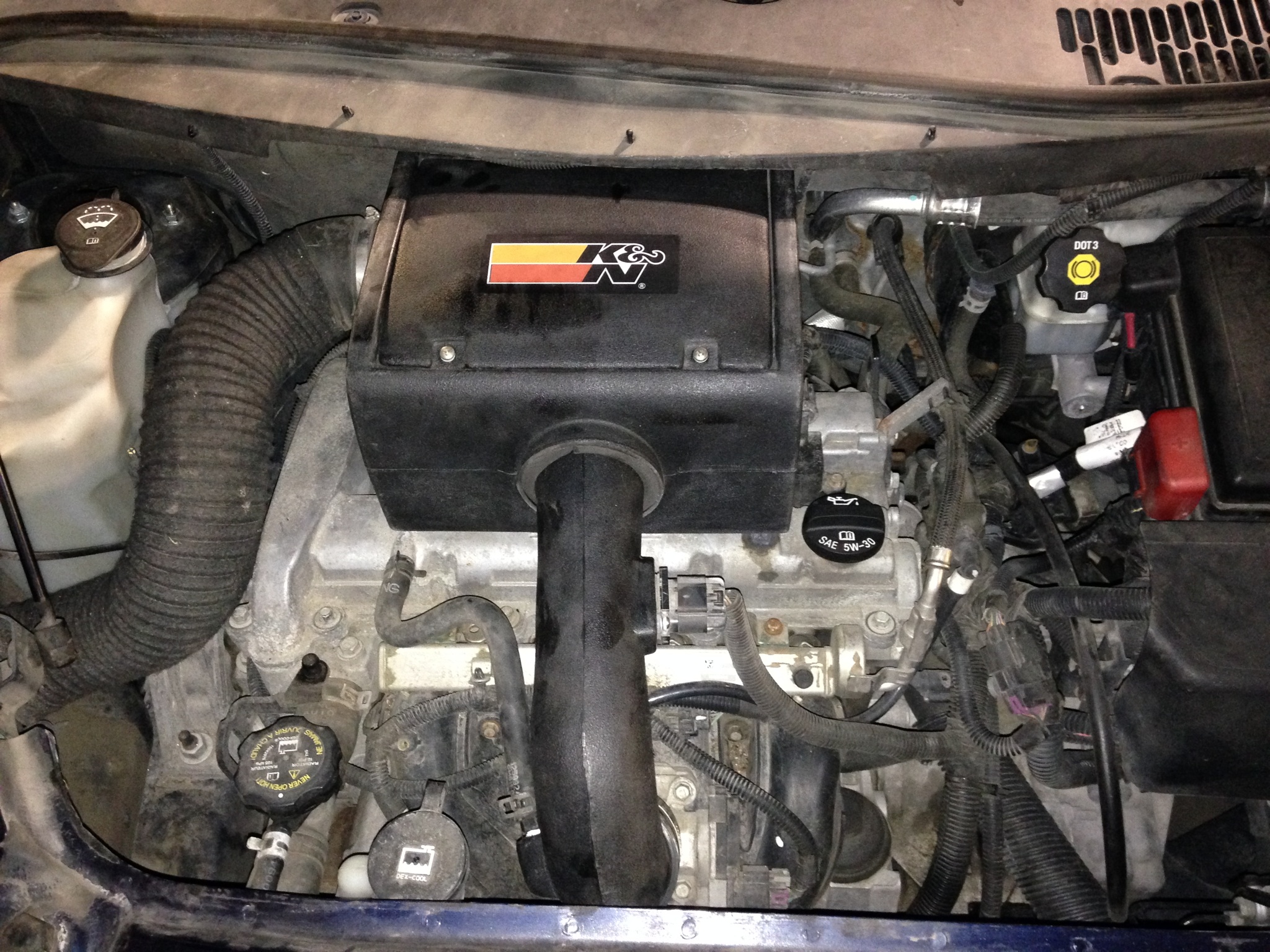

Another possibility, my car was a test mule for Weapon-R for fitment of there Dragon Cold Air Intake and I ran it for most of the 100k miles. I mention this since I had an issue with the throttle body and an associated trouble code around 30-40k, basically had to clean the throttle body.
There was to me, an awful lot of dust accumulation throughout the intake.

Sounds like that Dragon CAI may have let more dirt into the engine then they thought it would, only one way to find out, test it down!

I never mess with the stock air intake for that very reason. Its not a racecar, so why do you need all the extra air, some mods are just not worth the potential damage, cai is at the top of my list. Keep it cosmetic and you'll never be the direct cause of a blown engine. Engine internals and sand (silica) are a bad combination. Lesson for everyone running aftermarket cai.
