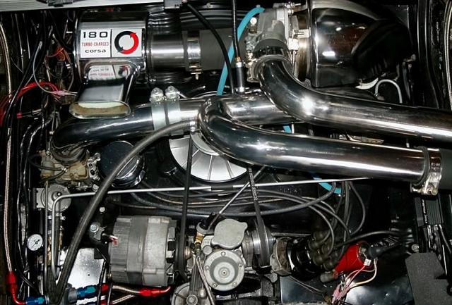

Here's a pic of the engine that is in the van now, its a 180 hp Corvair Corsa Turbo engine that I stripped down and had bored .30 over, that along with a billet stroker crankshaft bumped the engine from 164 cubic inches to 198 cubic inches(3.2L for you metric folks). The turbo is a unit made by Rajay for Corvair retrofits, its blowing into two Rochester RV-X carbs with 10 pounds of boost. The two large chrome tubes in the pic that lead off to the right are going into a modified Saab intercooler located in the right rear wheel well, its also running an electronic boost controller with an Air Research waste gate. All this adds up to 292 hp on the dyno, its quite the step up from the 140 cubic inch 95 horsepower engine that I pulled out of the van. Now its not done enough to drive for more than quick test hops, the additional power is overwhelming the rear suspension and giving me some headaches.
Still have lots to do, like fabricating a new engine cover, converting the rear suspension to one from a 1965 Corvair, upgrading to disc brakes all around, and a few dozen other things.

First off, that is truly bad ass! Thanks for the pics.
