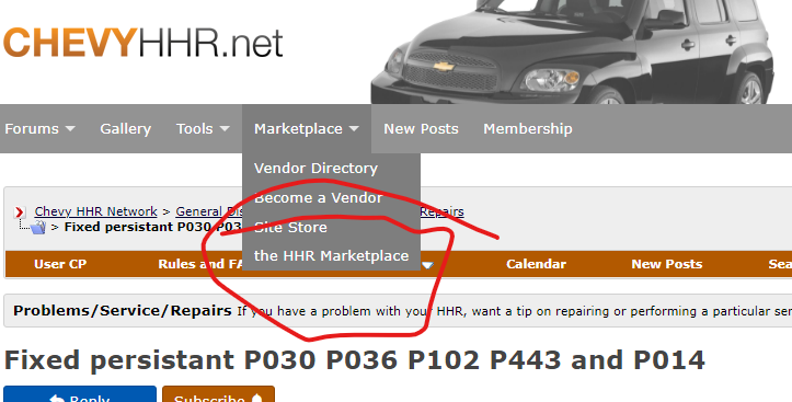

Did you ask here? Pretty sure that would have been my first response.
Please edit your post to remove the for sale part and put it in the HHR Marketplace instead (where for sale belongs).
