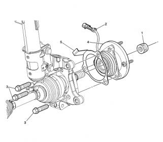

This next up on my list, anyone have a writeup with pics?
Old Jul 19, 2011 | 12:29 AM
no write up but something just to give you an idea..
HHR Axle nut 81 ft lbs, & Hub bearing bolts are 85 ft lbs.
