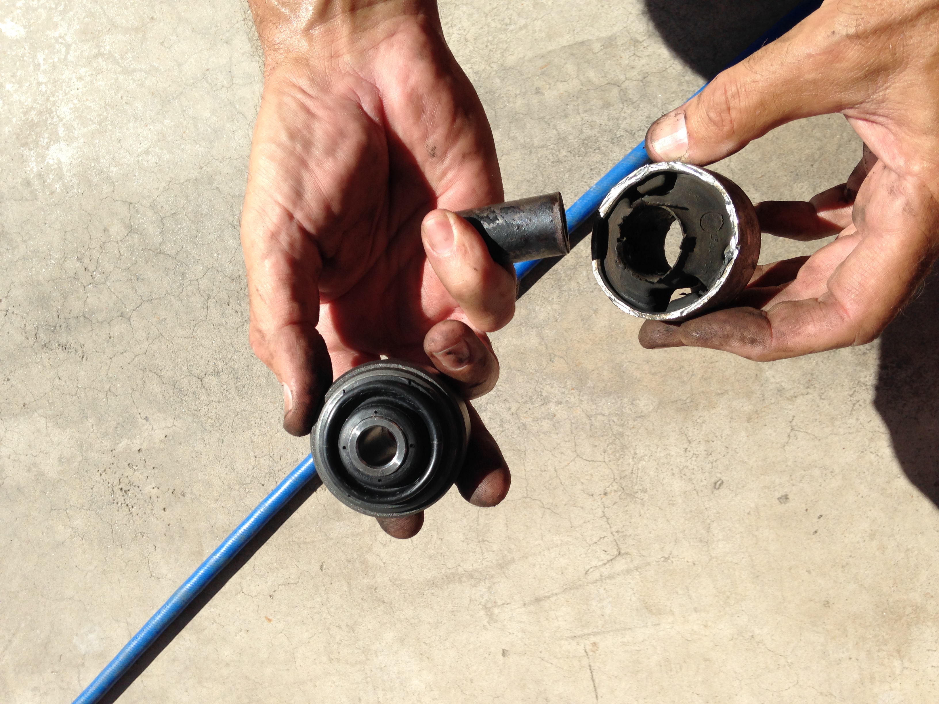

X2 look to the rear drums for correct adjustment and the lower control arm rear bushings!
They can look like the one on the right, after you remove the LCA but can be looking just fine

We understand that, however we have experienced this and determined these solutions!
The LCA issue can crop up after lifting the HHR on the hoist.
The rotors could have been resurfaced out of round , but I have seen replaced discs have the same issue!
