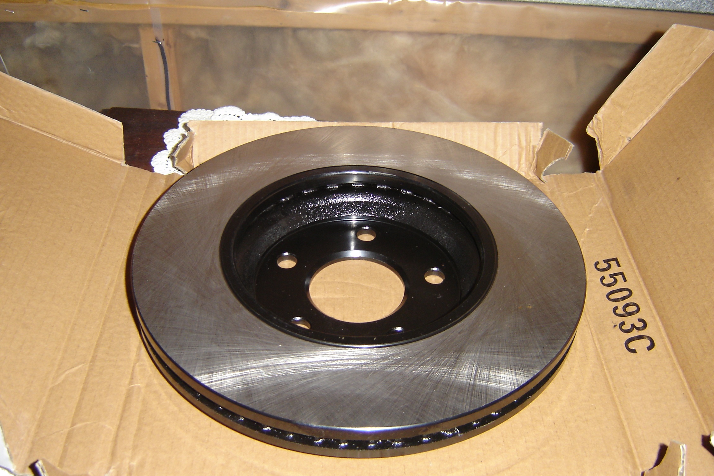

At your milage and from my 200,000 plus miles and personal experience with this LS model which has front discs and rear drum brakes, I believe your rubber lower control arm rear bushings are spongy if not deteriorated to the point of the one on the right integer picture I posted. That is the second set of original equipment GM bushings, junk after 100,000 miles just like the first set.
I changed over to Moog K200792 bearings, they in the picture on the left, instead of rubber or polyurethane, they are metal and nylon. Here is a link you'll need two

These have really solved my front end judder and I even had changed from my stock 10.6 brake discs to larger 11.8 inch SS brakes, the still juddered.
