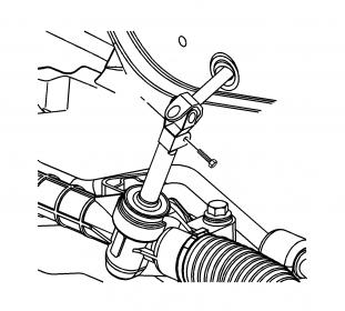

I had the famous clunking as well as a rattle when I braked and in the end just driving on a rough road. Thought it was the table bushings for the clunk as I recently changed the end links. Dealer said it was all in the steering column. They changed the column, and apparently my intermediate shaft was seized so they freed that up and lubed it. There was no clunking after that...for a day and a half. The rattle is still gone but the clunking noise came back. It started out very lightly and within a day and a half, it's right back to what it was before they changed the column! I'm guessing when I call them today, they'll tell me it's the intermediate shaft. So, back to the original question that started this thread, does anyone have any pics or diagrams of this shaft so I can see if it's something I can fix myself as my warranty is up and I just dished out $900 for the column?

Number 3 in pic
Another view
