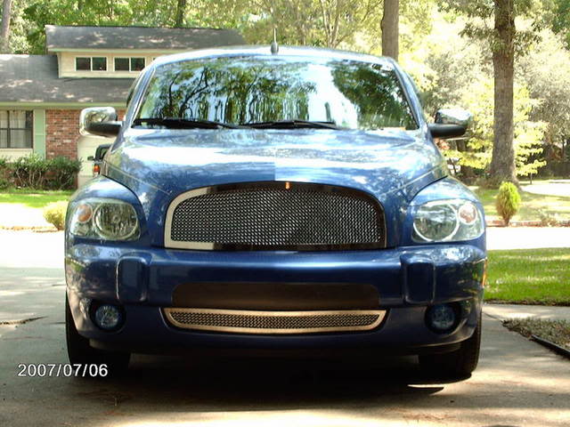

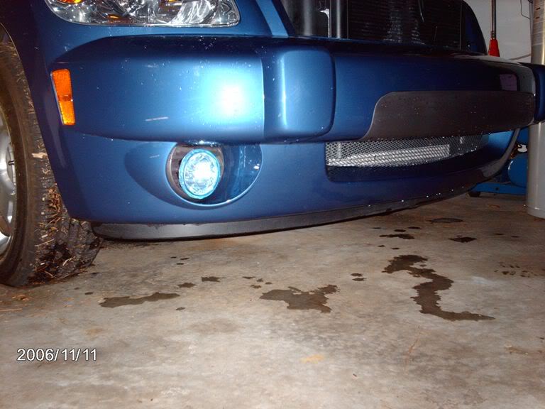

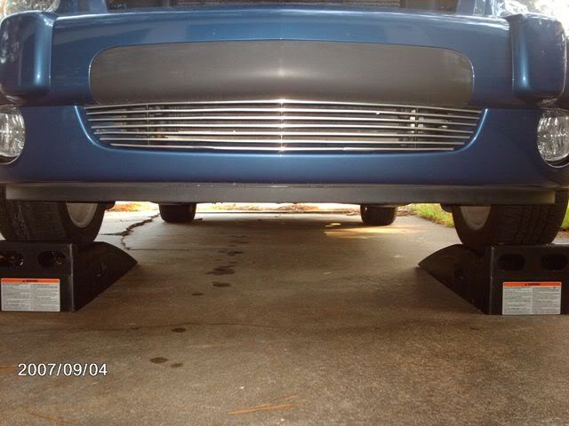

GM does have a fix for this. Did you ask the dealership for the guard they came out with? It would be free. I never did cause I already have my own. Actually, I've had 3 different ones....
Here you can see the "inexpensive" mesh version..
Then I went with a billet piece.
Tried a new upper/lower grill setup.
Wasn't happy with that so I went back to the stock grill/billet setup.
Working on 4 years in mine, it's never "popped" out ot gear on it's own.
