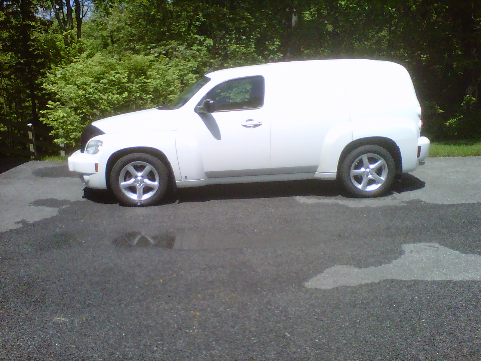

Smile front end bang when goin over bumps or steering too and fro
190K miles on my 2009 HHR panel and finally resolved the front end bang. OVER the years/miles I've replaced the struts and sway bar links @ around 100K (1st attempt), lower control arms which got the bushings and ball joints @ around 150K (2nd attempt) and finally replaced the sway bar bushings this past weekend (cheapest and easiest) - Finally victory! Sound is gone and as with each attempt handling improves back toward new. Loving my little HHR yet again.
