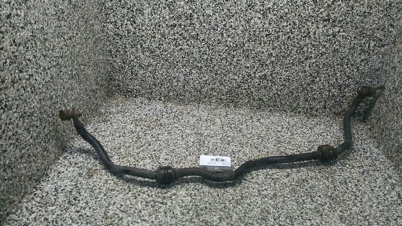

No pix, the stops are just plastic rings about 1 inch wide fit by friction.
You can almost see them in this pic:
