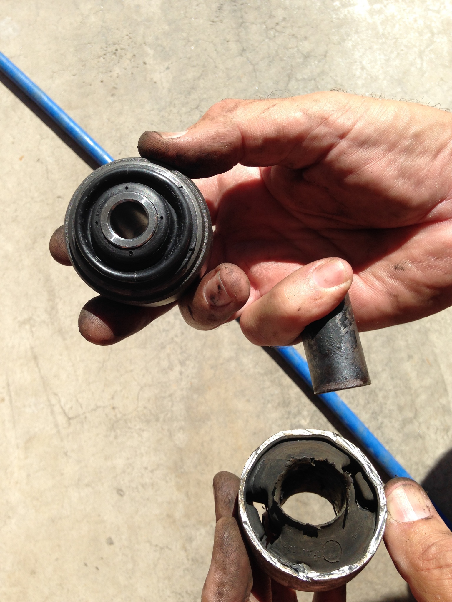

Old Aug 5, 2016 | 11:27 AM
Posts: 39,984
Mine turned out to be rear LCA bushings, this time!
And one time upper strut bearings,
And another time sway bar links, that's when I replaced the bushings too!
The dreaded front end clunks can come and go, but then after 215,000 miles a lot of stuff wears out!
