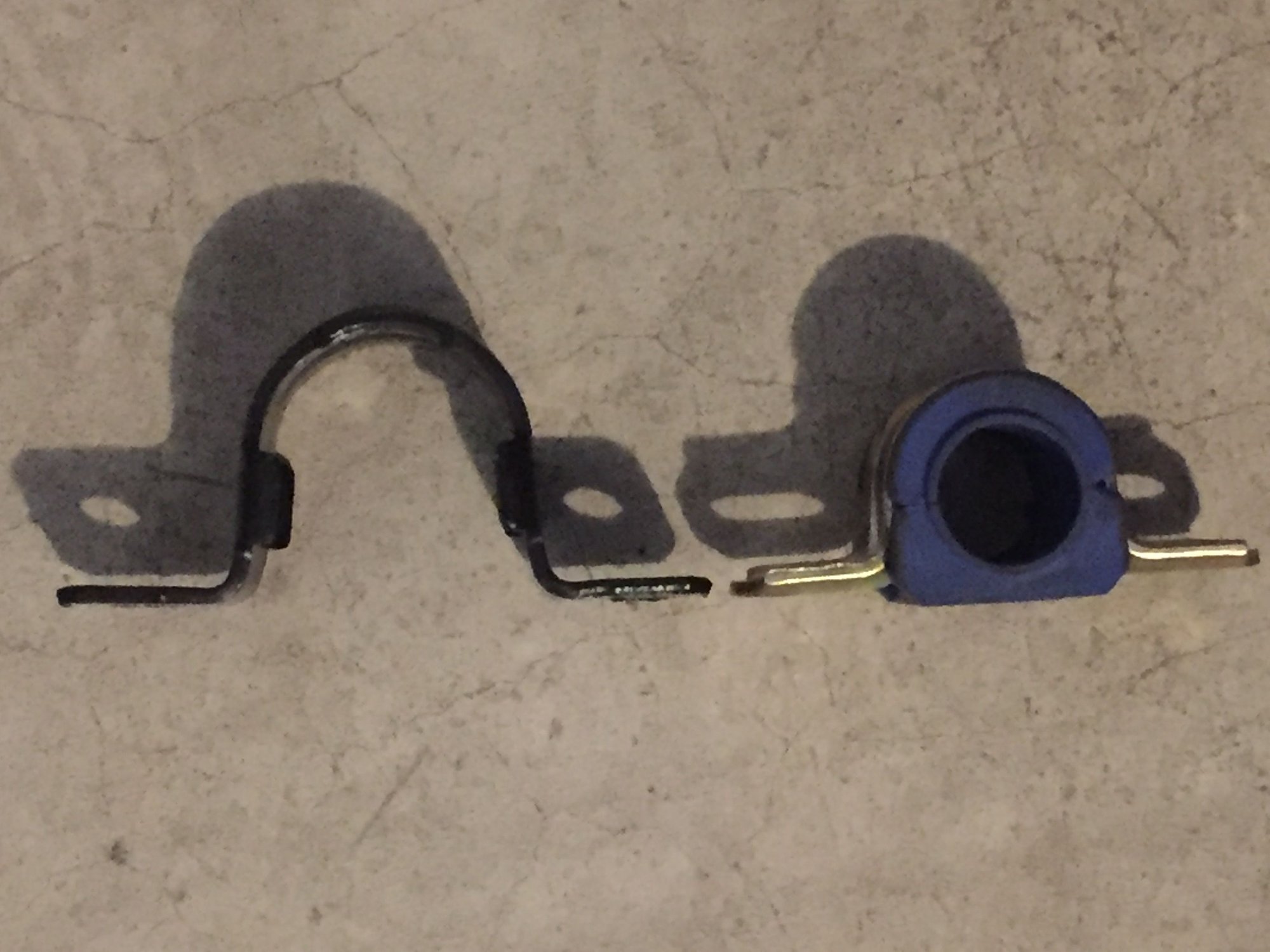

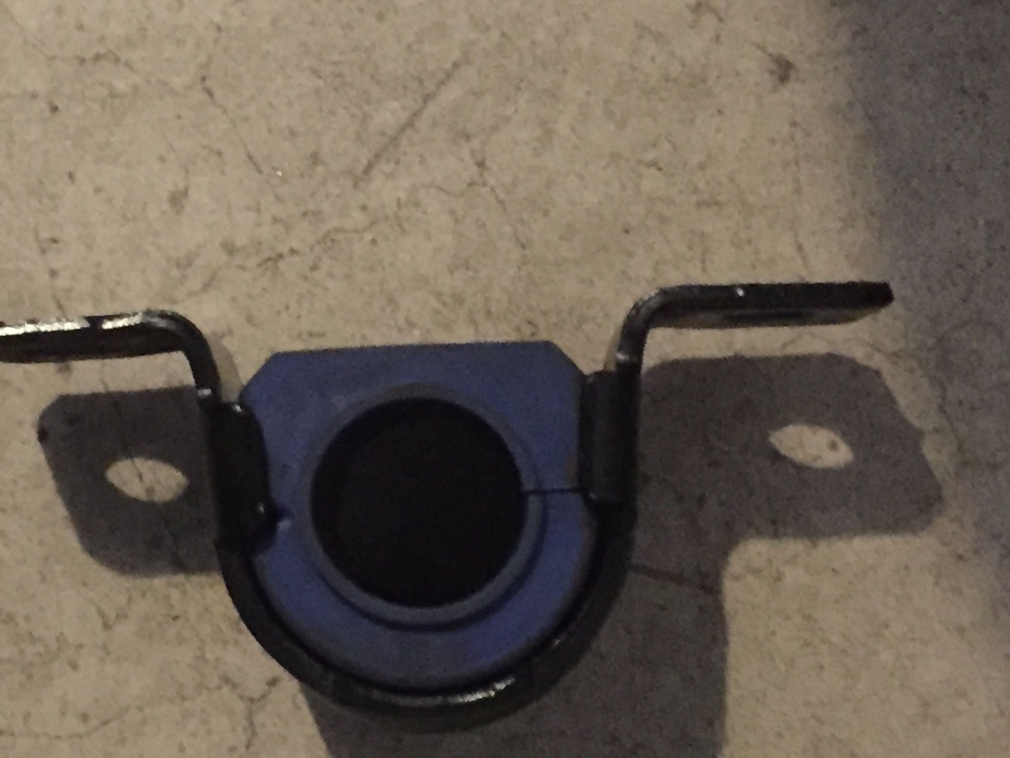

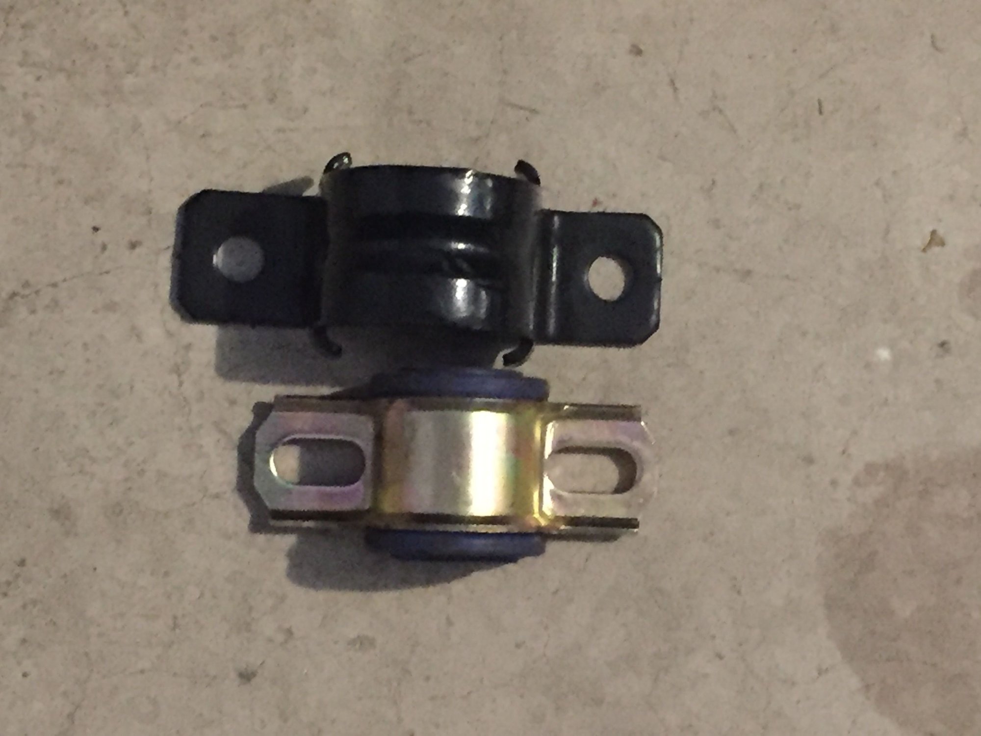

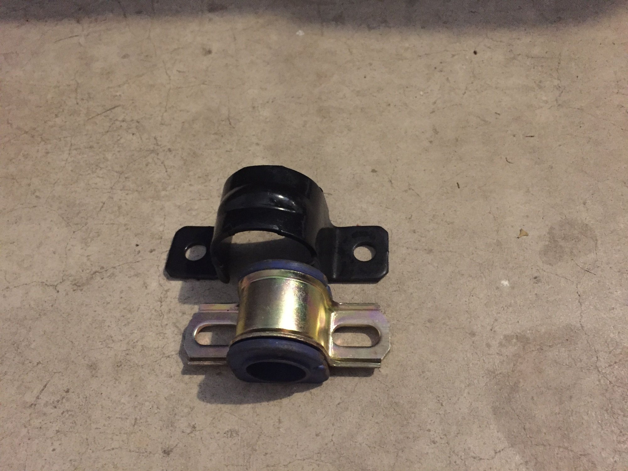

And ensure you get 25 mm bushings, not 1 inch bushings!
The 25 mm Moog bushing, note how the bracket is smaller then the black OEM
Quite a difference in size
Nope you can’t put the Moog bushings in the OEM brackets
Definitely the bolt holes don’t line up!
