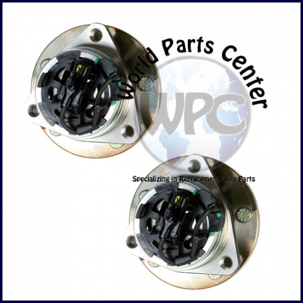

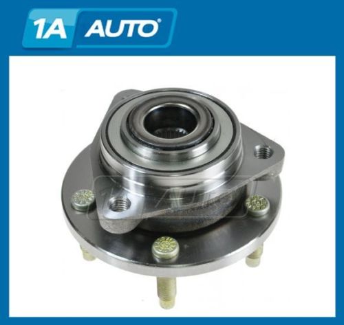

I just called in 2 repair shops - the GM dealer and an advanced private car service. Both tell me that the replacement of the bearing is not possible. Replacing only the "hub assembly", the entire unit as a whole.
Thus, the dependence of the ABS is present. If you watch the picture, you'll see:
hub "without ABS" - a simple piece of iron;
http://cgi.ebay.com/ebaymotors/06-07...item51996e53f7
Hub "has ABS "- a piece of iron + plastic superstructure, some connectors and wire.
http://cgi.ebay.com/ebaymotors/2-FRO...item4154fd108e
You will have to adapt the hub "has ABS", it means - breaking a plastic superstructure.
You know, it is not advisable. Hub "without ABS" is cheaper, buy it and not torment your head.
Pick out the bearing from the hub, too, do not advise. You'll have to use a saw, but no significant savings in money.
Good luck.
