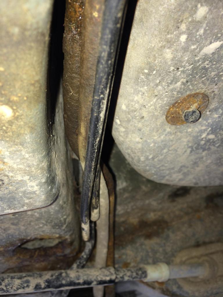

It's Saturday and my fuel line is leaking as fast as can be behind the rear wheel on the drivers side. I got it jacked up, jack stands in place, fire ext in hand, cleaned off the rust and junk and freed the 4 lines from the black plastic clip. Here are photos. I "thought" I could free the lines, use a plumbers pipe cutter to cut out the bad section, install some hose and hose clamps and be on my way an hour ago.
I didn't know (Hell I STILL don't know) why there are two lines that look like fuel lines. I know which ones are the brake lines….
Anyway…HELP!

THANK YOU ANYONE WHO HAS THE KNOWE-HOW TO ASSIST ME!

EVAP vapor line. They all need a perfect seal.
Or, the obvious, if you think it's going to explode seek professional help. But liquid gasoline does not burn easily.

OK Don, thank you for identifying the other line and the good advise concerning gasoline. I pulled back the protective cover/heat shielding since it was soaked and hiding issues and used a small amount of scotch abrasive to break off the large surface scale. That was the result you see in the photos. Since it is getting late I knew I had to take it off the jacks for the evening. I needed to start the car to move it back about 4 feet. I now have a strong stream of gas peeing directly onto my exhaust pipe. It's quite amazing to see.
So everybody, I am broke so I can't use the services of a professional mechanic. I do have some skills with a wrench but this is a new one on me. Anybody want to take a step by step procedure that could end up fixing the problem? It would be appreciated!

A piece of fuel line rated tubing and a couple of hose clamps should work. The fact that it is "peeing" while running means that it is the pressure line from the pump.
Gasoline is bad for some rubber compounds, so be sure to get one that says "gasoline". The other 2 things are addressed in the body of this thread. Flare fittings or compression joints. Take your pick, none are safer than the next. The "safe" answer is to replace the entire line, for liability reasons that is the advice given.

As donbrew said, the safe thing is to replace the entire line. If you try to just patch the bad section, it probably won't be long till it leaks somewhere else.
From looking at your pictures, you have some serious corrosion issues going on under there( guess it's one of those northern winter/salt things ?)
I would be taking a close look at other things like brake lines, etc.
