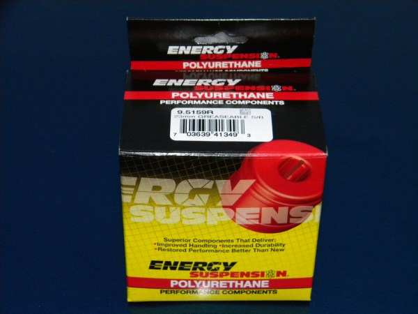

Sounds like your sway bar bushings are needing lubed up front, a bit of silicone spray lubricant will "shut them up" for a while. If they look like they're crumbling and cracking, try Energy Suspension for replacements. Since you have an SS you'd need the 23mm size.

I have an extra set of the bushings. But I think it is the top of strut, mine did it when I was up in Canada, -14 °F, the dealer up there said it's a lube deal. If you want the bushings 20.00
