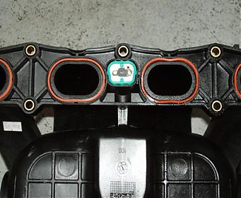

If the SI diagnostics do not isolate the root cause of this noise, perform the following steps to improve this noise characteristic:
Follow the Intake Manifold Replacement Procedure in SI to remove the intake manifold.
Remove the PCV orifice plate that is between the #2 and #3 intake manifold runners.

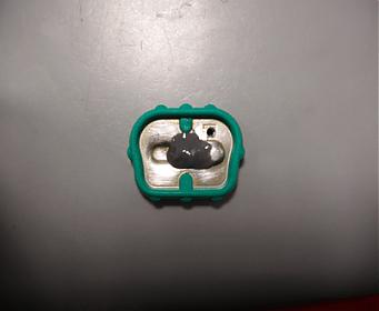

Plug the PCV orifice by placing a small amount of epoxy on both sides of the PCV orifice plate as shown below in Step 4.
Use a #51 (.067" / 1.7 mm) drill bit to drill a new orifice in the location shown below.
Install the PCV Orifice Plate as shown below.
