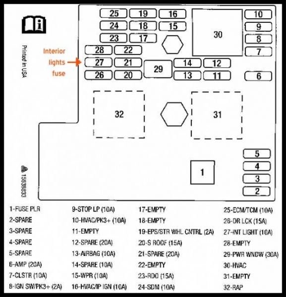

Check the cluster fuse, #7 in the interior fuse panel
