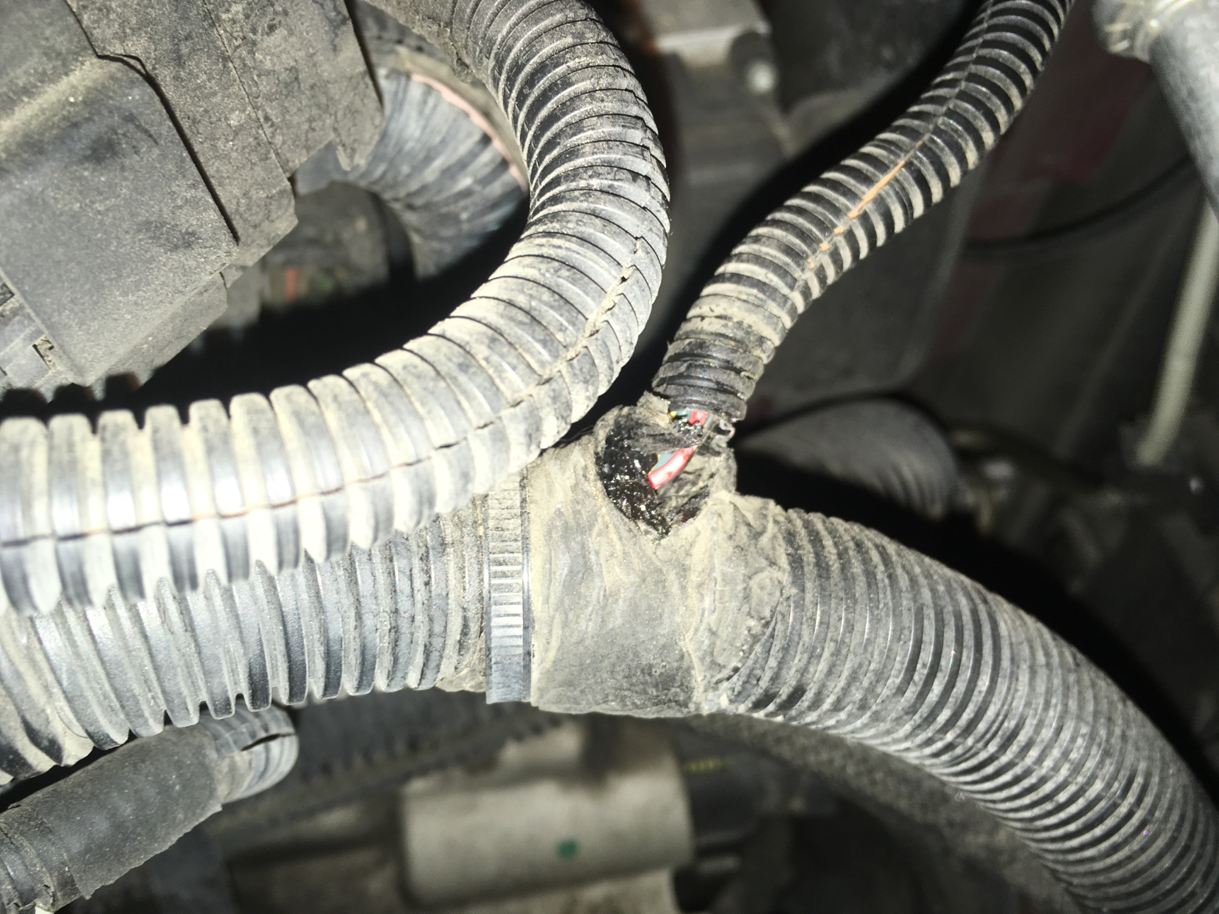

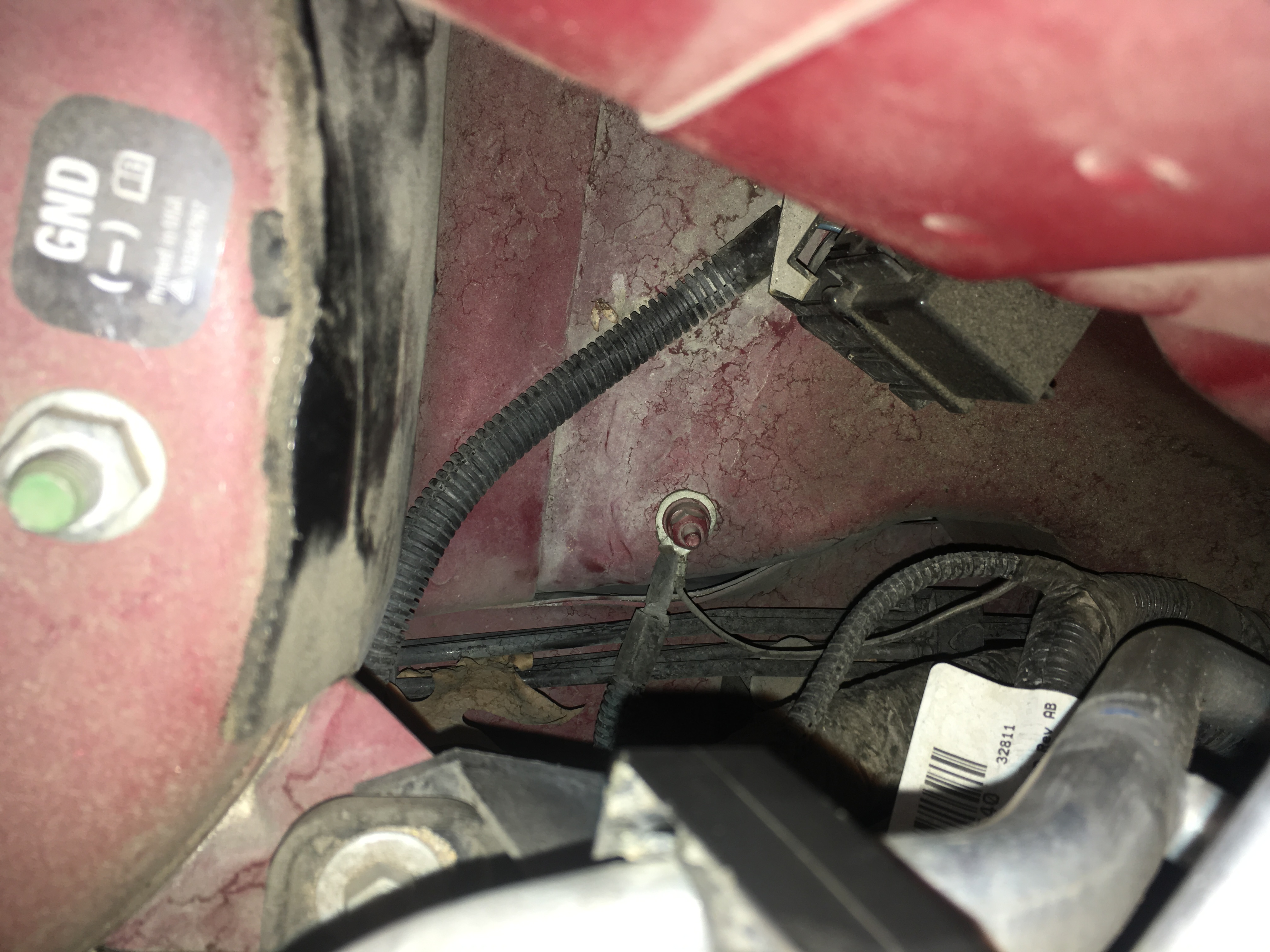

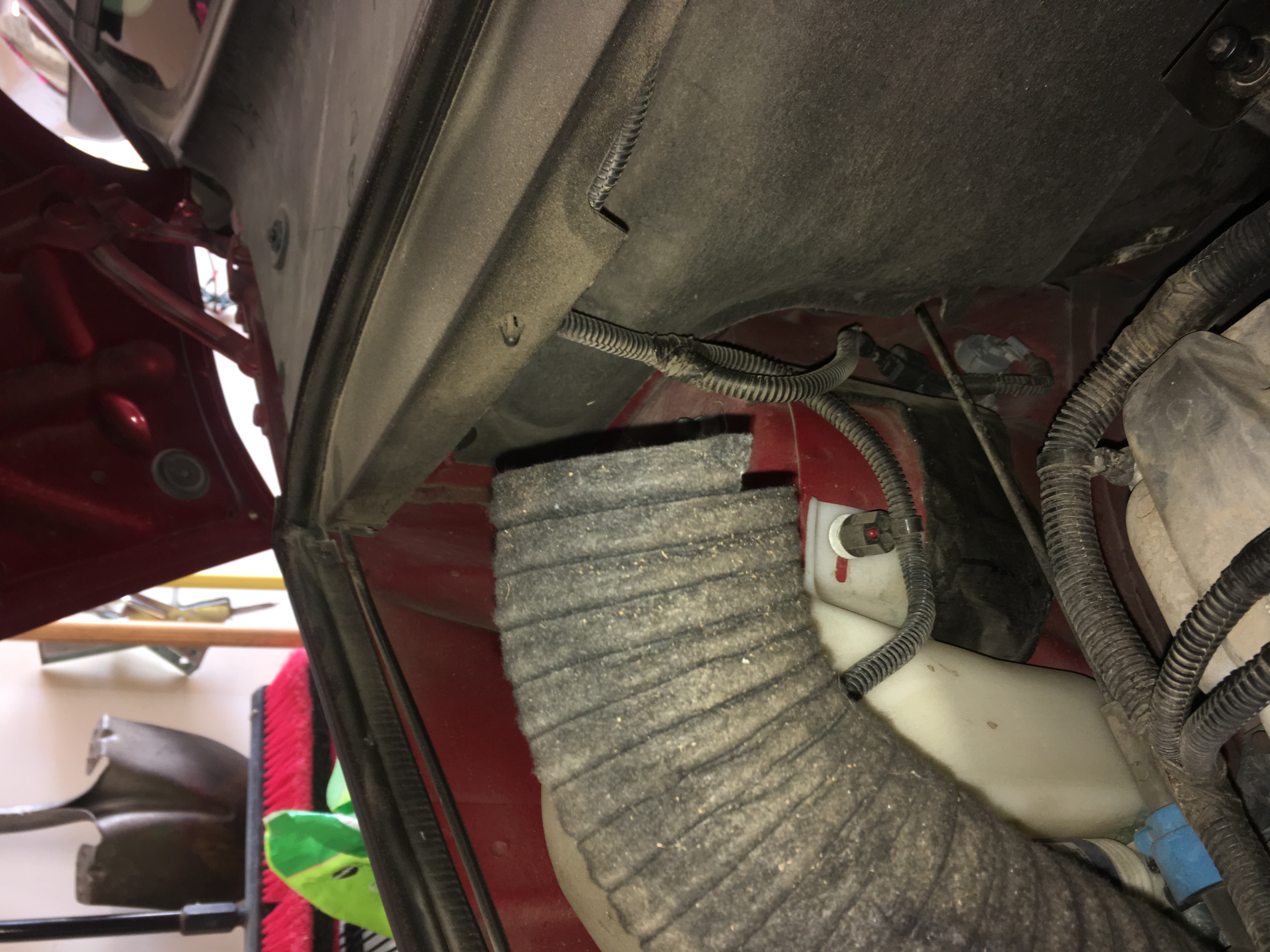

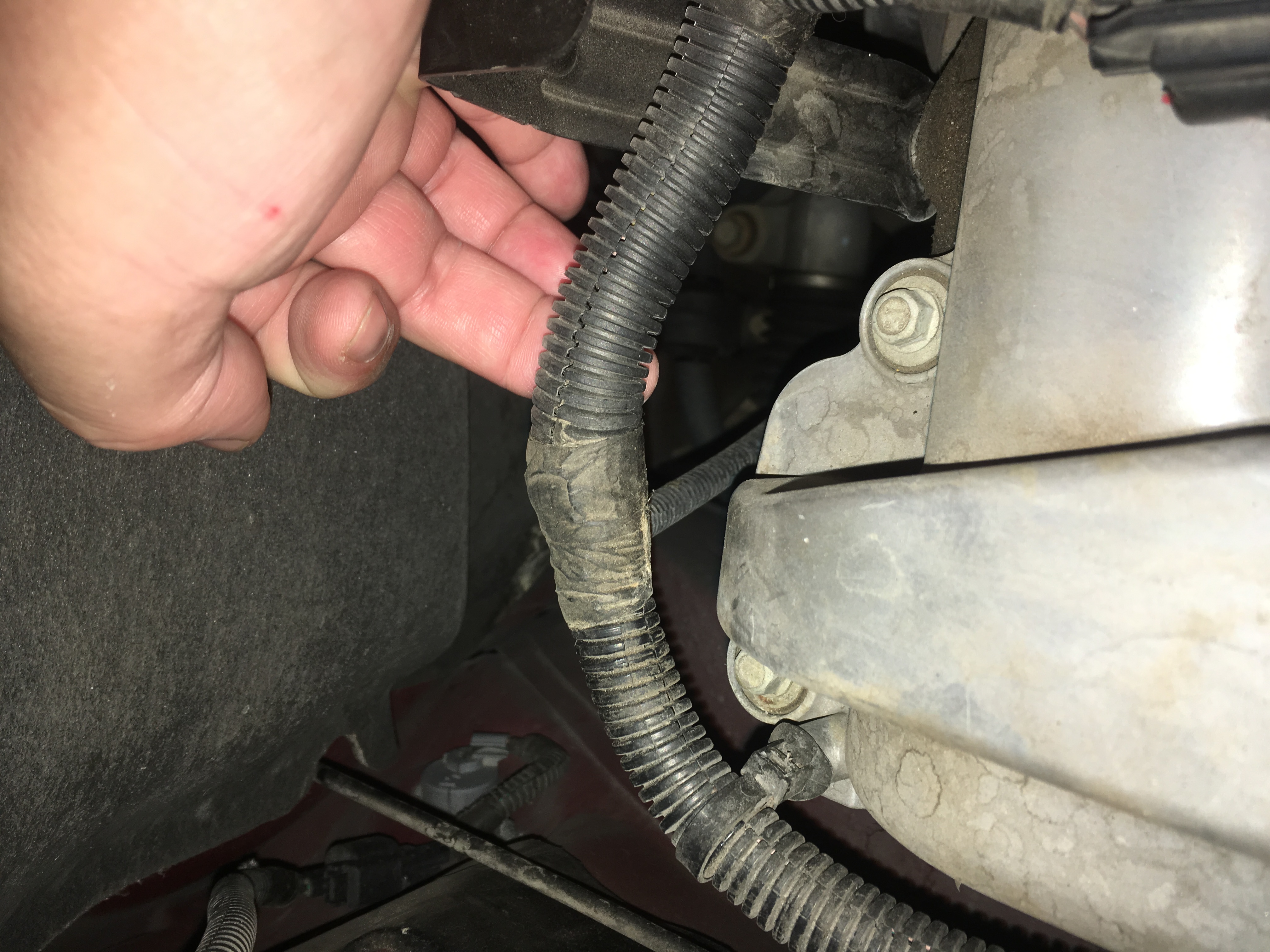

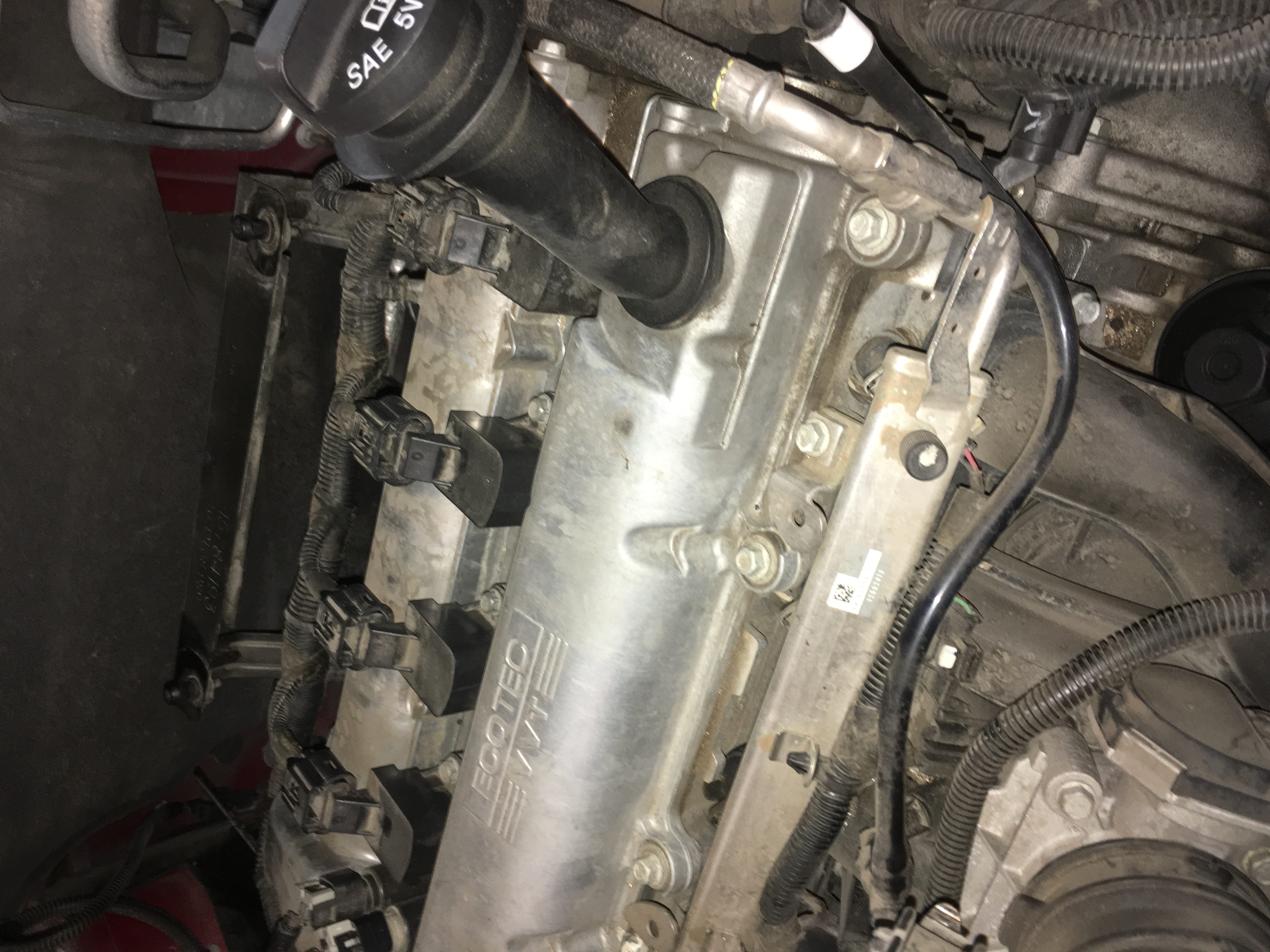

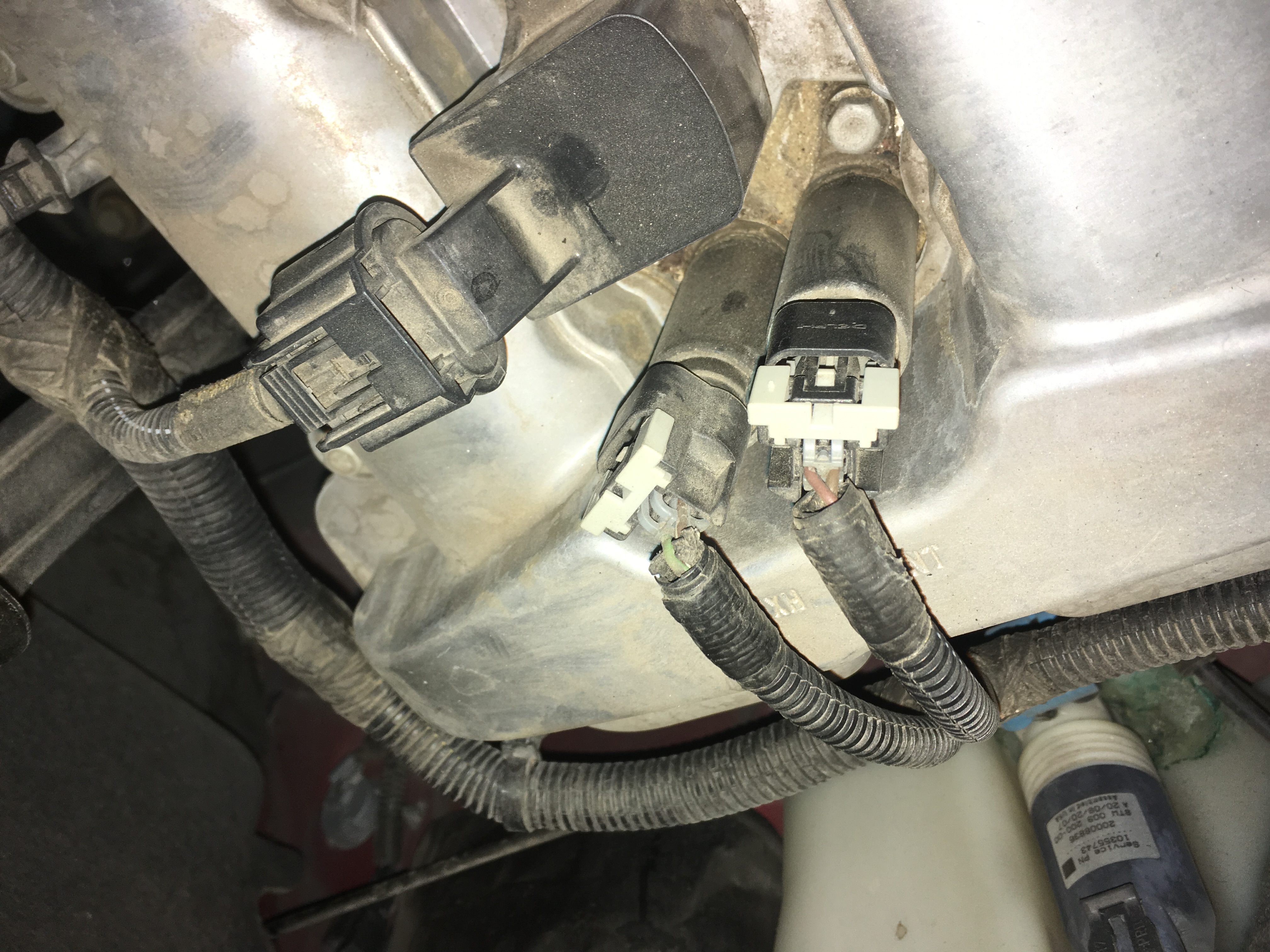

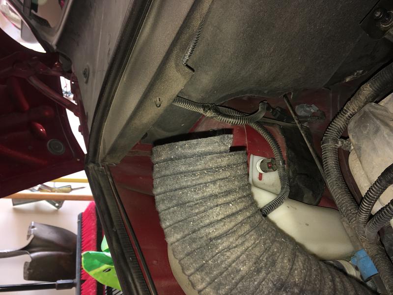

So I'm looking at wiring and grounds but dont see anything that looks damaged or loose, I looked at the driver strut but noticed there isnt a ground there. there is one however before the strut, took a photo and it looks to be tight and i followed the wires and there are no frays. There was one piece that looked questionable but it was just the tape that connects the two wire protectors coming undone, and one piece that seemed to be stuck to the valve cover but once pulled off there was no issues.... should/could I sprat the MAP sensor and throttle body off while I have the intake stuff removed? Also the felt hose thingy came unraveled I was curious if i could just clamp it back on after removing the piece that was staples to the plastic elbow? I'll be checking fuses as well just in case.
Here are pics in case you see something I dont.
Attached Thumbnails HELP Error codes I cant seem to find!-img_0247.jpg   HELP Error codes I cant seem to find!-img_0248.jpg   HELP Error codes I cant seem to find!-img_0249.jpg   HELP Error codes I cant seem to find!-img_0250.jpg   HELP Error codes I cant seem to find!-img_0251.jpg

Try snugging the bolts that hold the fuse box together up.

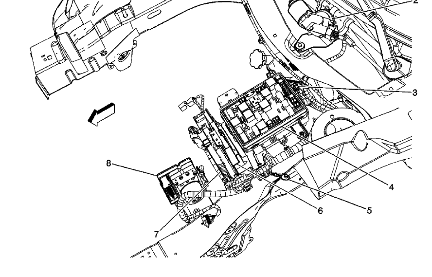

??Here are most of the grounds. https://www.chevyhhr.net/forums/how-...04/#post810394

The "strut tower groud" is #5 in this drawing.

Also to your comment, That is the ground i found(pic #1 i posted, albeit a sideways shot) and it was very snug with 0 wiggle at the eyelet. should I take it off, sand the area to bare metal retighten then repaint it or just check tightness with a wrench?
