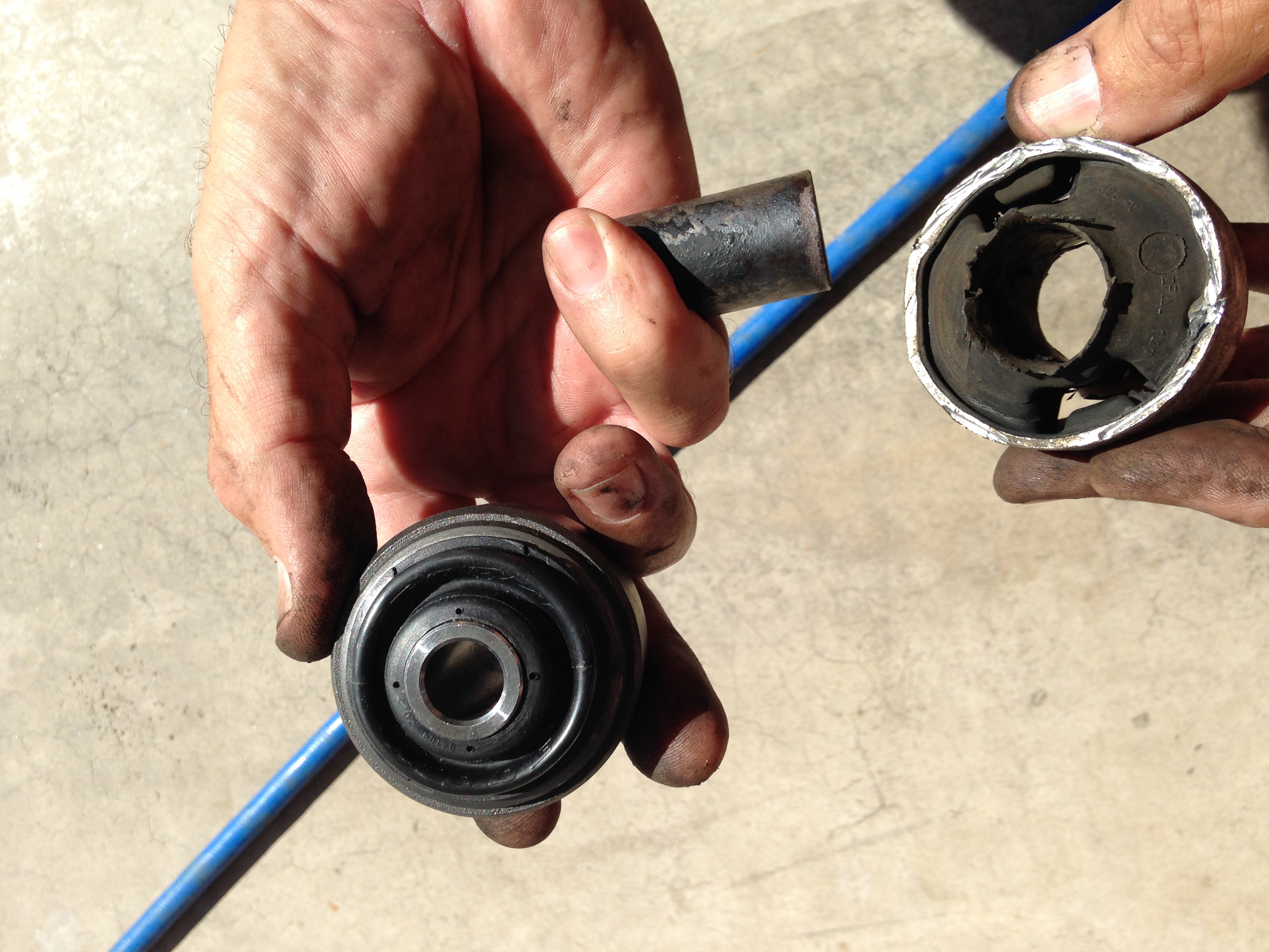

Thanks for the info the people she went visit with had a friend with a couple of rims for sale off a 2011 hhr how lucky was that she got the rim and went to pep boys for a new tire Pep boys put the car on the lift to check for any further damage only thing they found was both lower control arm bushing are wore out need replaced car has a little over 37 thousand miles on it. I was wondering would a full size spare fit in place of the donut tire. Thanks Again
Old Dec 20, 2015 | 03:34 PM
Posts: 40,091
No a full sized tire doesn't fit back there, long story but I found out the hard way whilst on vacation once. As for the LCA bushings get a pair of Moog K200792 problem solvers that's one on the left in the picture!
It's not so much the milage but the age of the rubber ones! I used a ball joint press to change them .

Thanks for the info old blue I was hoping the full size tire would fit will have to check into having the bushing changed.
Old Dec 20, 2015 | 06:58 PM
Posts: 40,091
Change 'em both, they go in pairs, and are not that hard to change

X2, always do suspension components in pairs.
