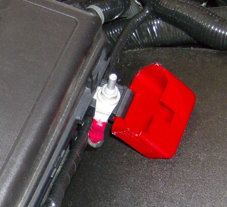

Old Dec 21, 2015 | 09:29 PM
Lucky's Avatar
Joined: 12-24-2007
Posts: 2,873
From: Seville. OH
Check this connection for the under hood fuse box.
