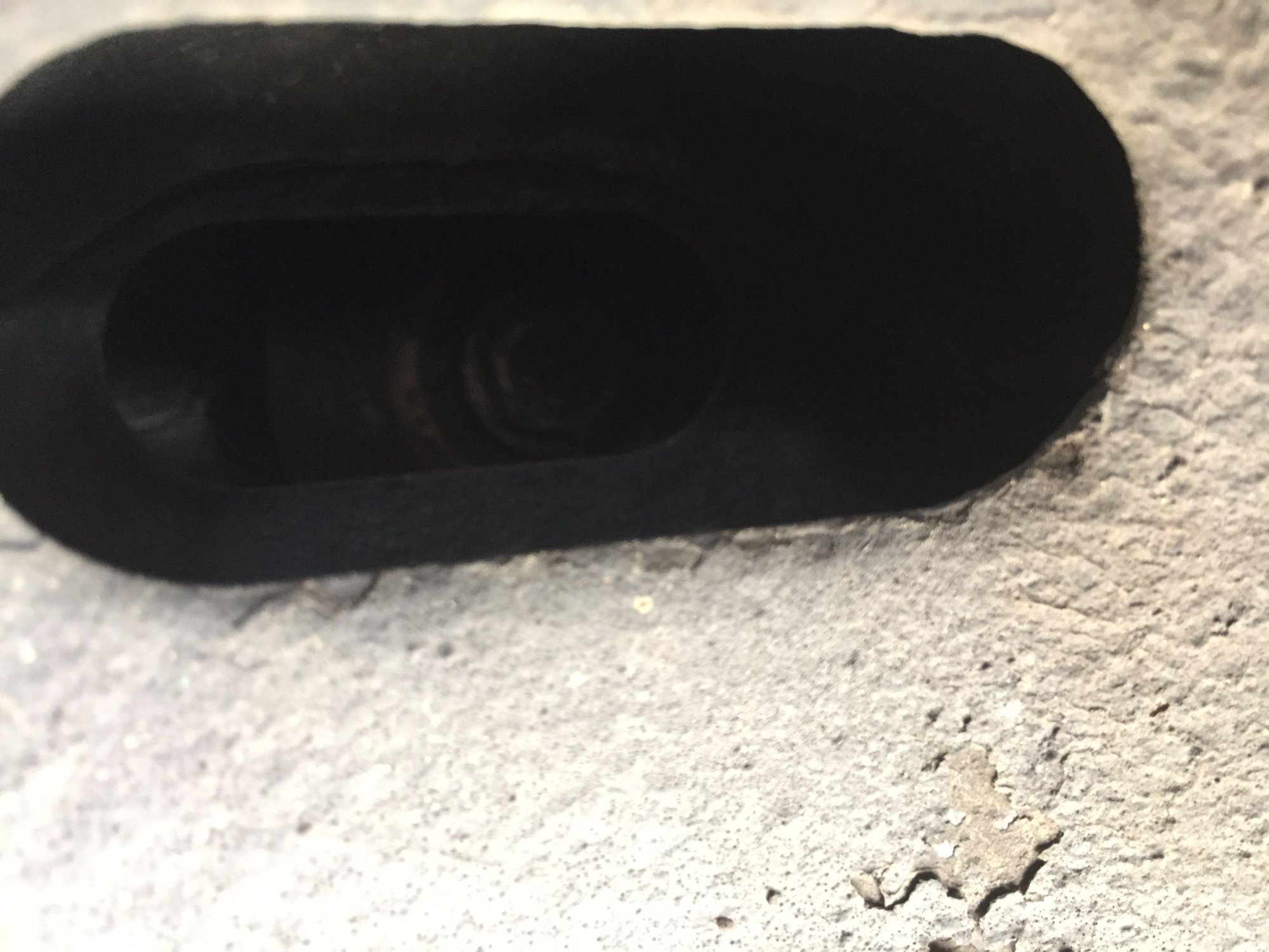

Now I’ve been thinking, a list of parts that I’ve replaced over the last 8 years and 225,000 miles of ownership of Oldblue.
As stated the LCA bushings
Ball joints
Steering rack, included inner and outer tie rods
Intermediate steering shaft
One that eluded me was the upper engine mount, that was a daa moment, if you look Thur the slot in the passengers side front wheel well and see the bolt is down lower then the hole, replace the mount.
You can do it with a few tools and a floor jack to support the engine
See the bolt thru the second hole?
See how it’s lined up to the holes, if you can’t get a 15 mm 1/2 inch drive socket on a 12 inch extension on that bolt, the mount is Purdue much toast!

You're saying a bad engine mount will cause poor/dangerous handling?
