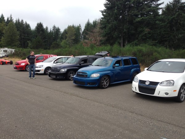

Great you got things cooled down, and it only took your Dealer 2.5 days, they must be getting better at it also. My Dealer took 6 months to decide to help me.
Since my buddies fan failed Saturday, we both drove mine in a endurance auto cross. Make 3 full runs of the course, the second 2 are timed and you get 2 runs. I was thinking it would gain too much heat but 203 was the highest temp I found even though I ran the second group. Now the tires ? different story.....
