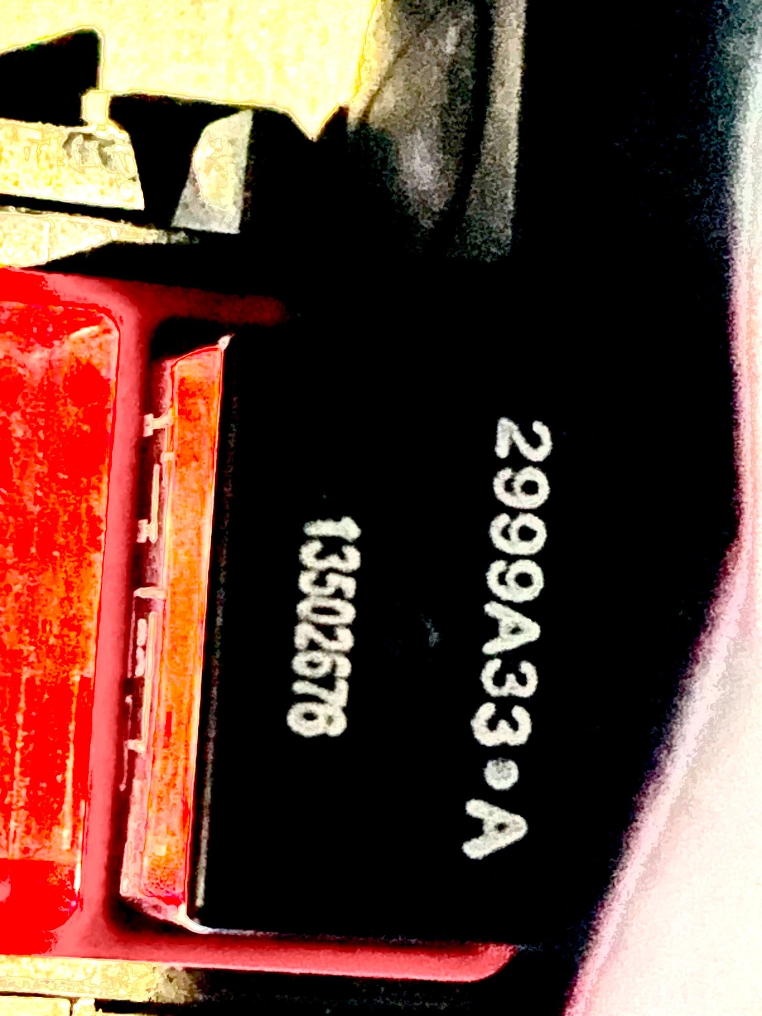

thank you for that diag. I attempted to trace the issue, and it turns out the ground wire under the right tail light had somehow lost the ability to ground well, which in turn had caused the relay fuse (the small black box on the left fender) to burn out. I re-soldered the wire, then covered with Vaseline and electrical tape, then went to Autozone and got the compatible Duralast relay fuse, and works perfect now. Here’s a pic of the OEM part
