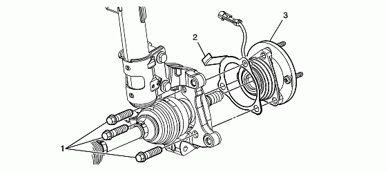

Does anyone know if the hub assembly bolts right in and out or does the bearing or shaft have to be pressed in place.

No pressing needed. If you've done one this will be easy.

Thanks this breakdown, is just what I needed!

You might want to look to see if your HHR has backing plates behind the rotors. If it doesn't have them now would be a good time to install them since you have to pull the hubs to install them. Early HHRs didn't have them. They replace the ring thats under the hub.
Chevy added them after complaints about noisy brakes cause by dirt build up on the back of the rotors, at least thats the story I got from the people here on the board.
