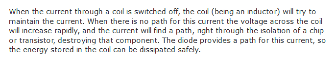

You check diodes with a VOM in continuity mode, should get continuity in 1 direction but not in the other.
I know the fuse box diagram says #50 is the fan relay, but it seems to be not there in most instances. I am not sure about it.
The diode works to keep the relay from "latching". That is why I'm looking there.
That was the problem with one last week.

#9 is the diode for the compressor. You might have a diode in the fan wiring harness near the connector. Here is the thread that was in. That diode was supposedly in only early 2006?
