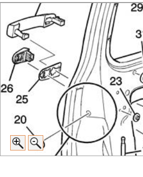

How to replace the cylinder lock of a door?

You get to the bolt that holds it through the hole under that piece of reflective tape. Is that the question?

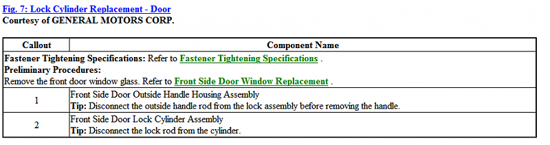

Here is the parts diagram from wholesalegmparts.com

That bolt under the reflective tape releases the outer door handle retainer piece.
It's a T30 torx driver!
For the door lock have a look in this thread
https://www.chevyhhr.net/forums/how-...ts-pics-45839/
