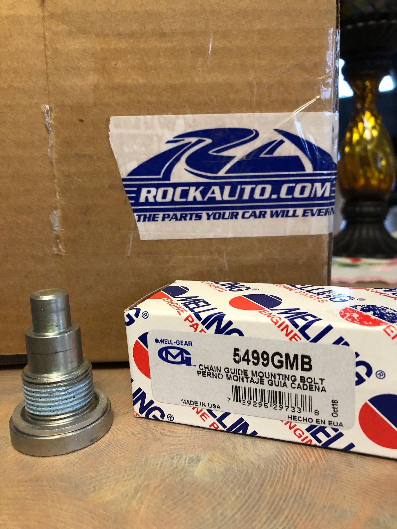

Maybe install one of these, the front guide upper bolt replacement
