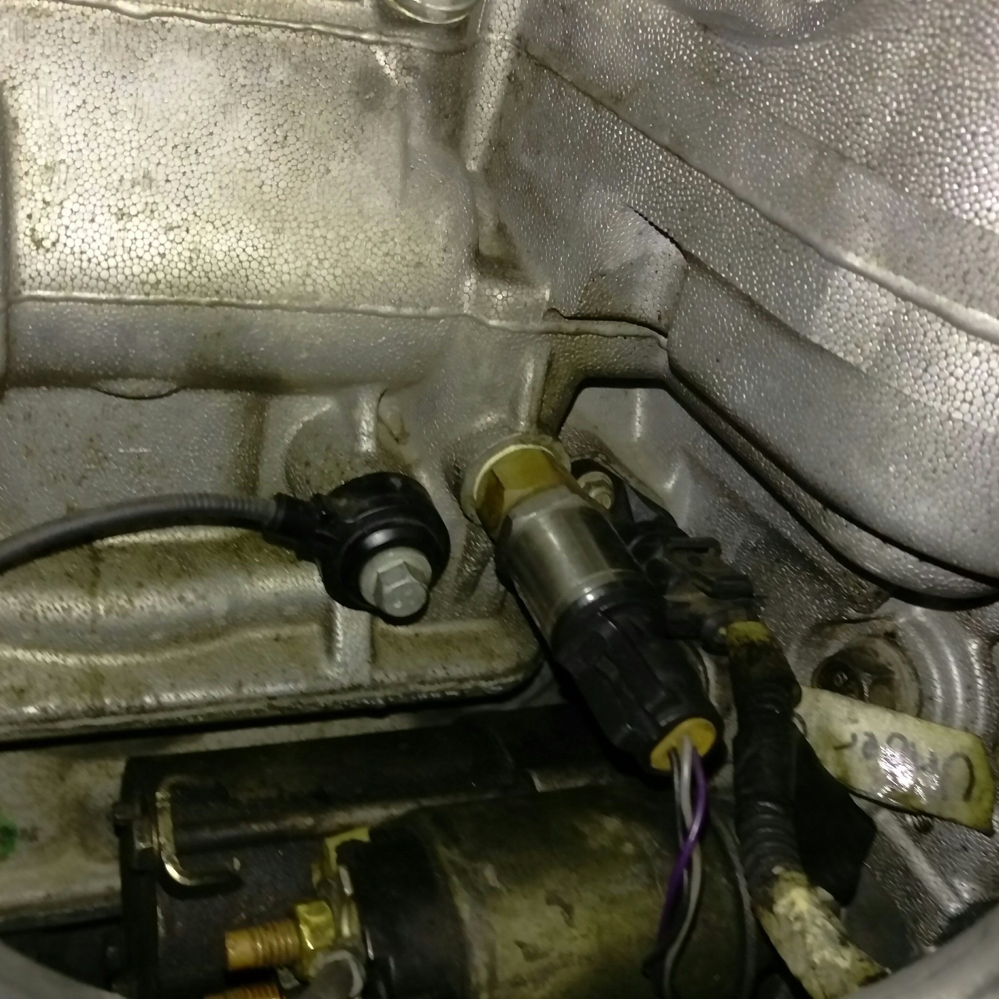

The oil pressure switch or sensor is located on the front of the engine below the oil filter housing just above the starter , you should be able to see it and see if there’s oil spread around that area.
That’s it with the wires connected to it on through the , that’s the starter just below it, and the knock sensor to the right.
Now, I’m confused, you stated the temperature sensor was disconnected, which was it? Think now, and I’m not trying to be disrespectful but just get the events in the correct order, to assist you.
