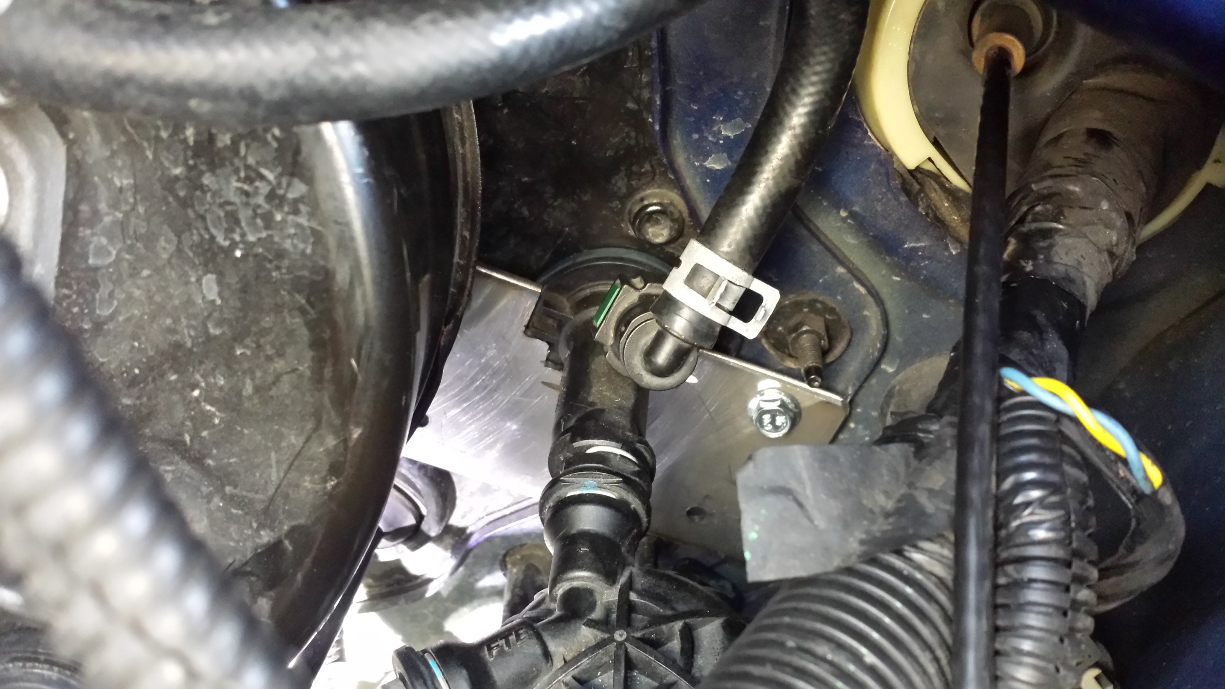

Just a thought here.
Would it be possible to find a write off and cut the section out of the firewall and bolt in yours?

That is an option.
I found this as what someone did. Granted it is on the Colbalt but as stated before the problem is the same I see how this fourm is-20141204_164602.jpg

That might work. This might be your part, # 10, GM P/N 20842466 fits HHR only, not Cobalt(see they are different!)

Interesting, I found another part number on a different diagram. It is for vehicles built 05/16/2008 & prior. GM P/N 15253760 Perhaps it was redesigned to the part I listed above, because of this problem. This part is a little less money, but I think you would want the new design.

Well I ran the P/N and we have a bingo for the HHR
Genuine GM Reinforced Plate (15253760) : OEM GM Parts and Accessories | GMPartsCenter.net

That 15253760 part may not be quite appropriate - note that the page refers to Auto Trans. Which is the same as at Chevrolet. #15253760: Cowl Panel Reinforcement. Reinf plate. auto trans

Both part numbers say auto, but they both say manual also. I don't know what happened on May 16, 2008, but that's the last production date for 15253760. 20842466 is good for all HHRs, 2006-2011. I bet if any of you auto guys looked, you'd see the provision for the clutch. But I don't know that 100%, because I don't have an auto.

The 20842466 has a longer fit list, might be the superceeded P/N and it shows for manual transmission!
Reinforced Plate | Genuine GM | 20842466 : GM Parts Direct: Your direct source for Genuine GM Parts
But it's special order
