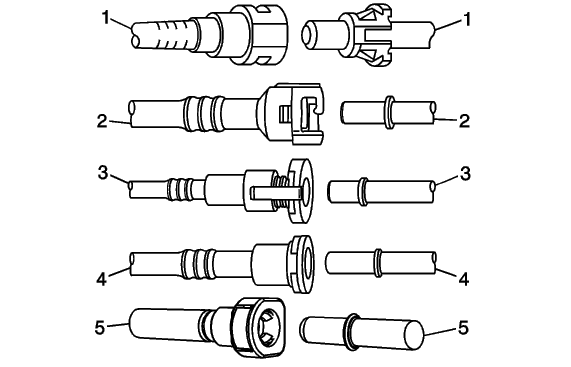

For the evap purge solenoid under the hood. How the heck do you release the hard plastic line in the back? I tried looking online the only video of it being down is a man speaking Spanish lol. The cobalt is different so no help there. The noise came back about a month ago after being gone for a but and it's definitely the solenoid but I don't know if it's the line connections or not. No codes or hard starts or anything like that just an annoying sound.... For now. Which is why I want to figure this out. I think I am having a one off problem here so the internet isn't helping
Old Feb 12, 2017 | 09:13 AM
Posts: 26,533
Same as the front. the white tab slides out.
You might try putting some grease in the connection.
#2, I think.

Looks like the number 4 one. I will give it a go!
The #2 is the front hose; that one is easy lol
