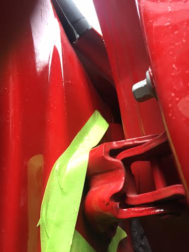

The next Morning I stepped into the panel to find a flood on the passenger side.
The leak was not under the Cowl nor the Sunroof. Both were dry with some Fir tree needles which i vacuumed up.
The leak was the Rubber bellows for the passenger A Pillar door wiring harness. The Top portion of the seal was not sealed against the body A pillar. I did notice that the rubber bellows had a slight wrinkle in the sealing edge. This leads me to believe that this bellow was never properly installed at the GM Factory.
The plastic retaining ring inside the bellows "locking tab" would not latch and secure the bellows in place. I've not seem a retaining ring like this particular piece. And since its cold,, raining hard and my '56 Chevy Coupe in in my only work garage.
I parked the my Panel in a small detached garage and taped up the bellow for now. I also made a water gutter with the painters tape on the top of the door hinge, similar to the oem rubber seal on my '56 A pillar.
Next Spring I'll deal with this bellows. I'm not going to pull the door to fix this bellows, so the black hard plastic retaining ring will most likely be eliminated. The bellows isn't leaking now and the panel is always parked in a garage.
