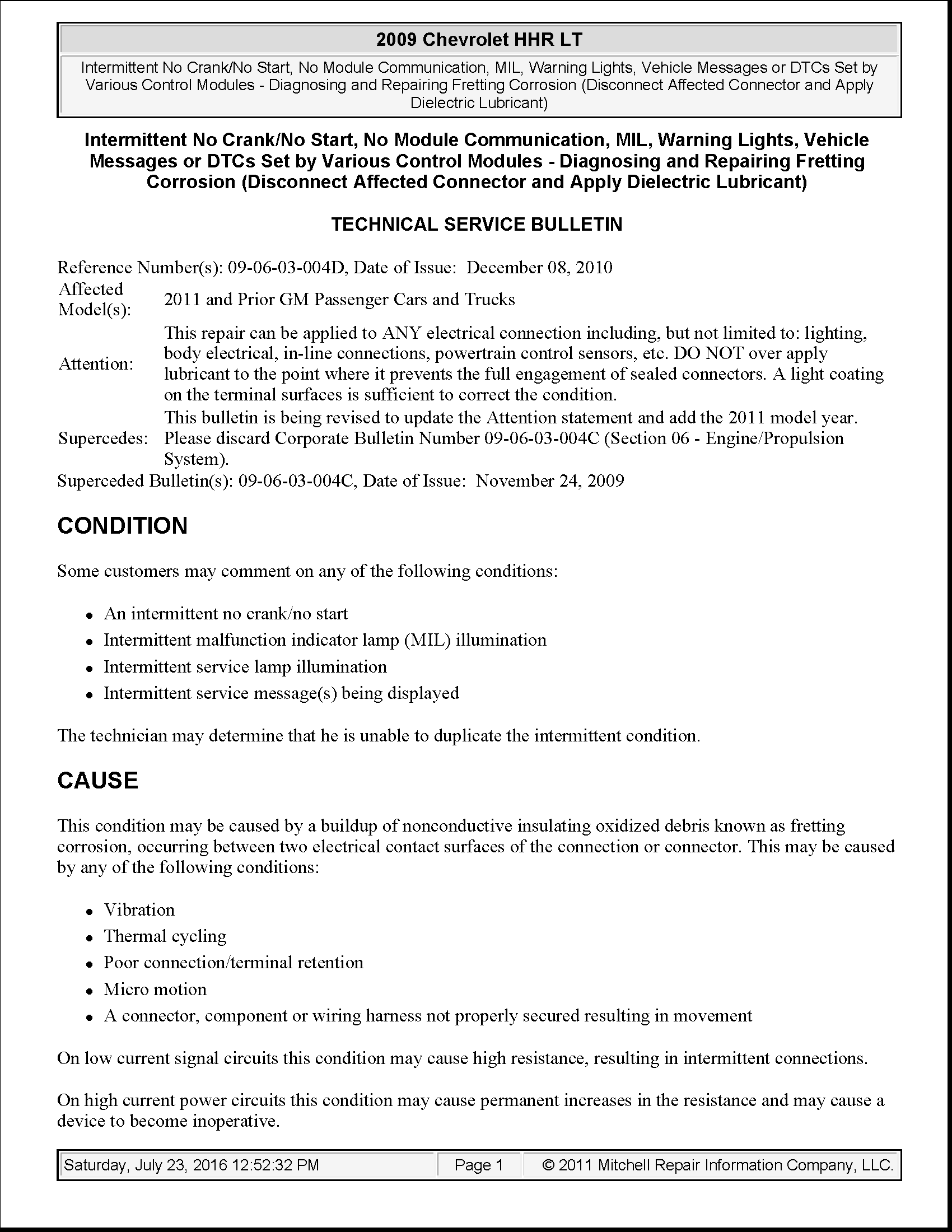

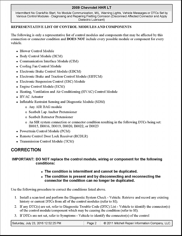

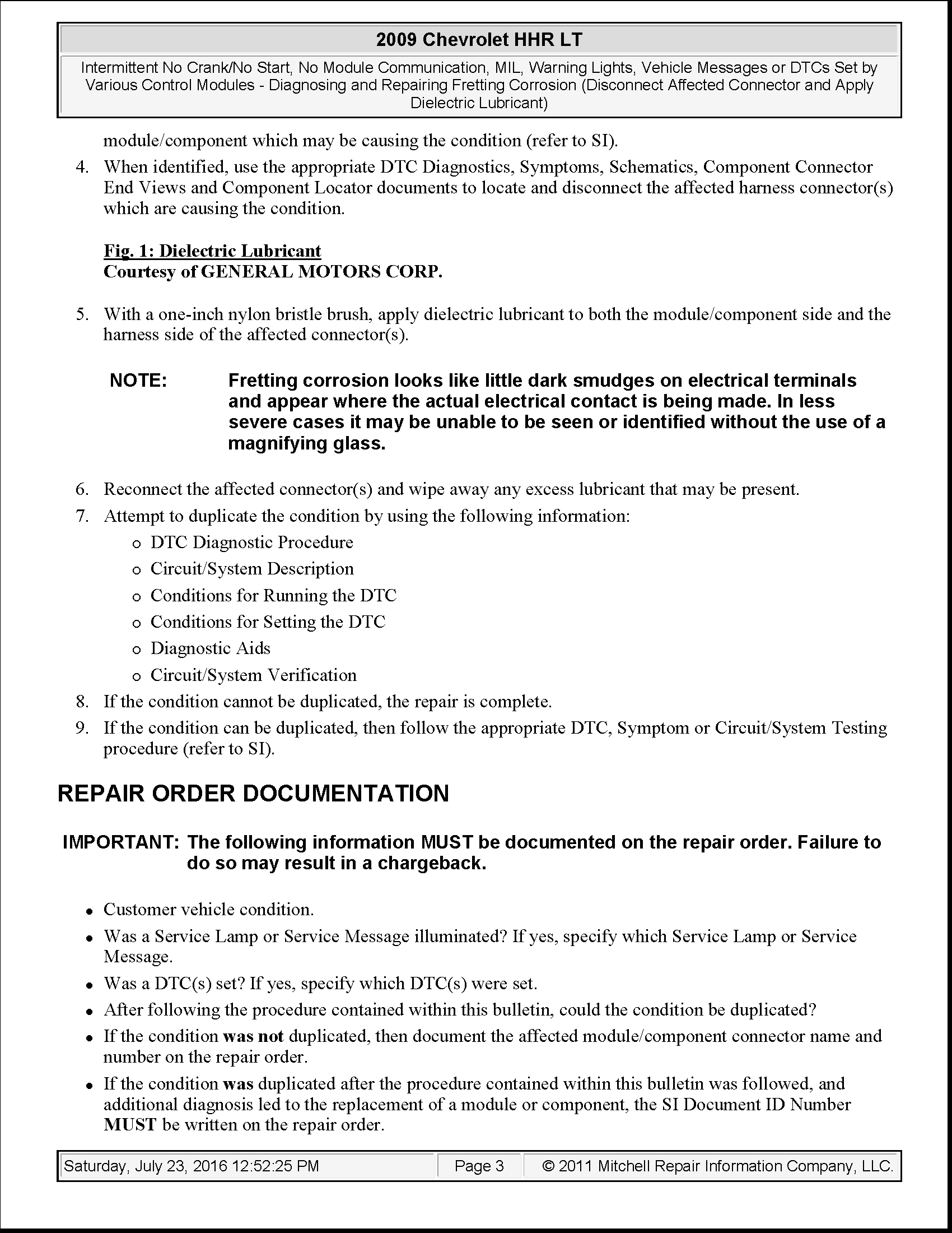

Here is the TSB:
Attached Thumbnails Intermittent No Crank/No Start, No Module Communication, MIL, Warning Lights, Vehicle-tsb09-06-03-004_page_1.png   Intermittent No Crank/No Start, No Module Communication, MIL, Warning Lights, Vehicle-tsb09-06-03-004_page_2.png   Intermittent No Crank/No Start, No Module Communication, MIL, Warning Lights, Vehicle-tsb09-06-03-004_page_3.png

A great find, we've been saying for years check the connections and grounds!
Nice find and thanks for sharing that Don.

Thanks, good post donbrew. The General recommends the use of dielectric lubricant, although very lightly. Puts that debate to rest, for me anyway.
