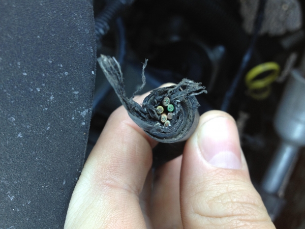

Look what I found loose under the hood..
I just noticed this, and had recently had my vehicle in the dealership for a motor mount replacement recently.. Never seen this before.
Old Feb 26, 2012 | 12:41 PM
Like I said in my e-mail, that sure looks like the section of the harness that goes to the automatic transmission...well if you had one. Didn't they replace your wiring harness last year, or has my mind gone completely?
If they did do the harness, its probably one from an automatic equipped "donor" HHR and the tech just snipped off the unneeded pigtail. You should tape it up with good quality electrical tape to keep it from shorting/grounding out against something, and it will also keep the inevitable corrosion from working its way back into the harness.

Back on 4/19/2011 they did this...."Cause: Engine harness chafing at TPS signal J7720 Bulletin 08-06-04-022B 9527 WC 2.20 : Repaired wiring to PCM Connector,, Replaced 4 terminals"
Wonder if there is some connection, or if they did change out some of the harness.

If you decide not to investigate this to its proper and logical end – that being having who did this correct the problem “correctly”.
I would suggest you take the DIY fix one step further and seal the ends of each of those wires individually. In my experience just taping the end of the cut off loom can lead to corrosion problems across the ends of the conductors. Electrical tape for the most part does not keep moisture out and once moisture gets in, tape keeps the moisture in to do more damage.

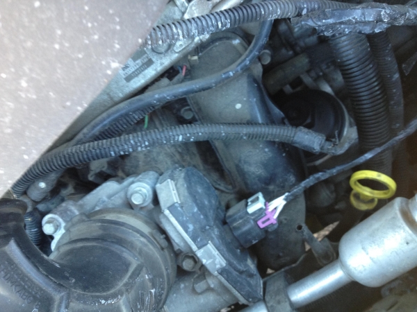

I do have an Automatic and from the looks of your second picture I believe 843de’s theory is correct about how this happened.
Notice the connector with the purple and gray parts, just below the cut off loom. On my Auto the cut off loom would connect there. Also notice the wire bundle connected to that same connector is “taped” up and the workmanship does not match the rest of the wiring loom.
I believe that this was part of warranty work, as I have not let anyone other than the dealership touch the parts under the hood..
I will be replacing the Rear Air Box Bracket again very shortly, and will at that time determine where those wires go as when I traced them this morning they seem to go under the box.

I just went out to look under my hood 2008 LT Auto. That is the piece of cable that goes to the throttle, instead of that new one in your pic, with the purple connector. So evidently they just replaced the entire loom. All the colors are the same, I note that all of the "new" wires are white.

so what you are saying is, they replaced it, and were too lazy to remove the old cluster of wires?
Old Feb 26, 2012 | 03:01 PM
Posts: 26,533
Yes. They probably would have to go track the bundle to where the next Y is, somewhere behind the motor I'm guessing back there to the next set that go to the ECM like the cam sensors temp sensor etc. I will bet that if you pull the rain cover off of the ECM (that hood thing in front of the fuse box) you will see another set of cut wires where the new wires connect to the ECM connector.
