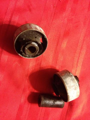

I had to replace mine on my 08 at about 68000. My 07 with 50000 still looks good. Here what my old bushing looked like when I replaced them.
the salt and weather here in Ohio don't help things.
