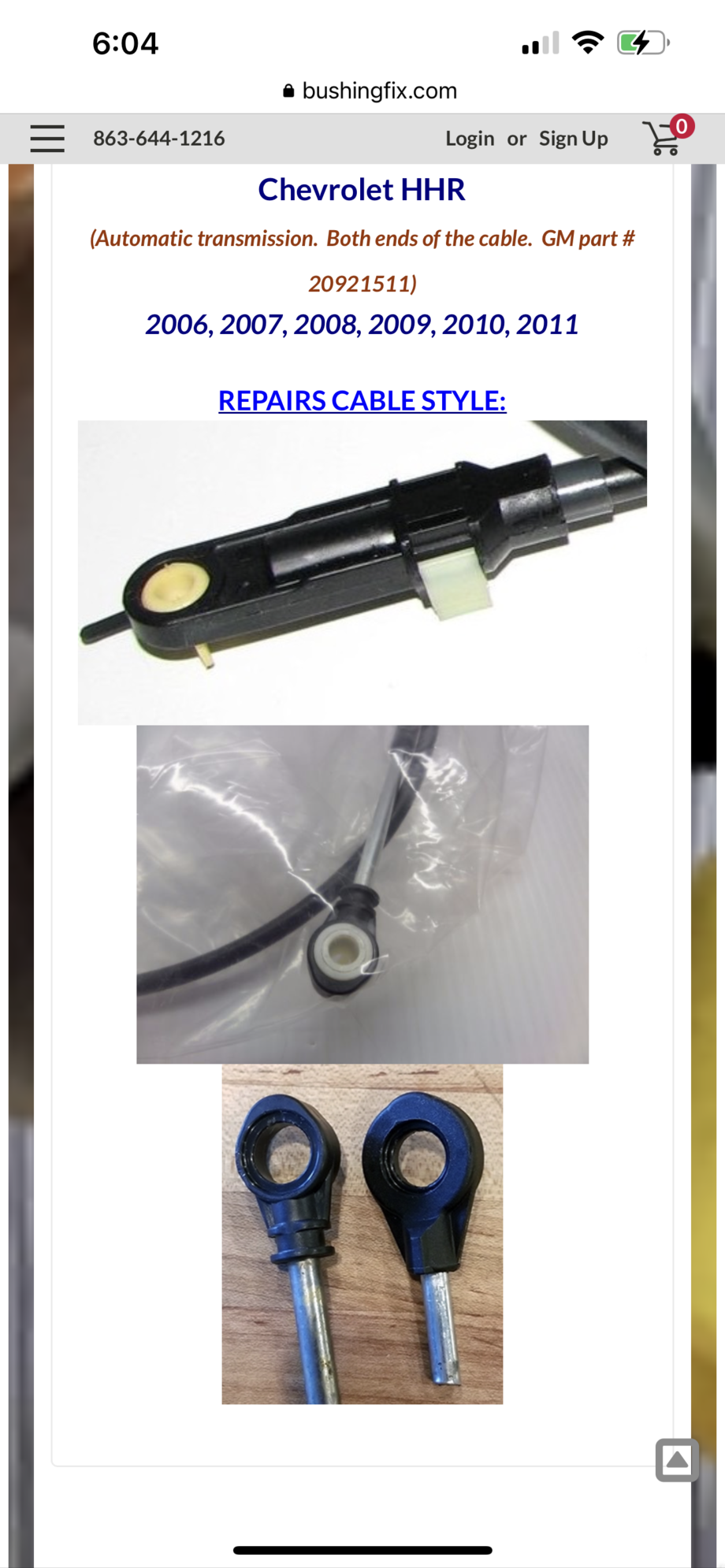

Seems the two rearward positions 2nd and 4th aren’t reaching their positions, I suggest you replace the bushing as it’s easier and less expensive then shift cables.

The link you shared for the bushing is listed for an automatic. Is it the same bushing for a manual?

I suggest you contact them to confirm, I searched manual shift control
