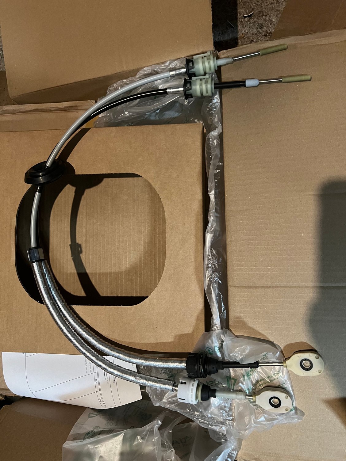

I stopped by my GM parts guru’s shop, he says the cables are available but bushings are not for the 5 speed shifters, he advises either take out a bushing and match it up at an auto parts help department, perhaps Dorman or other companies might offer a matching bushing. He also suggested to just replace the cables because the cables do stretch and corrosion jams them up.

Thank you all for the reply’s! I’m going to order 2 new cables and will give an update after I get around to installing them. As far as answering some of the other responses the clutch, front and rear brakes were replaced last year. Cars tip top for having 190k miles. This just suddenly happened.
Thanks again everyone!

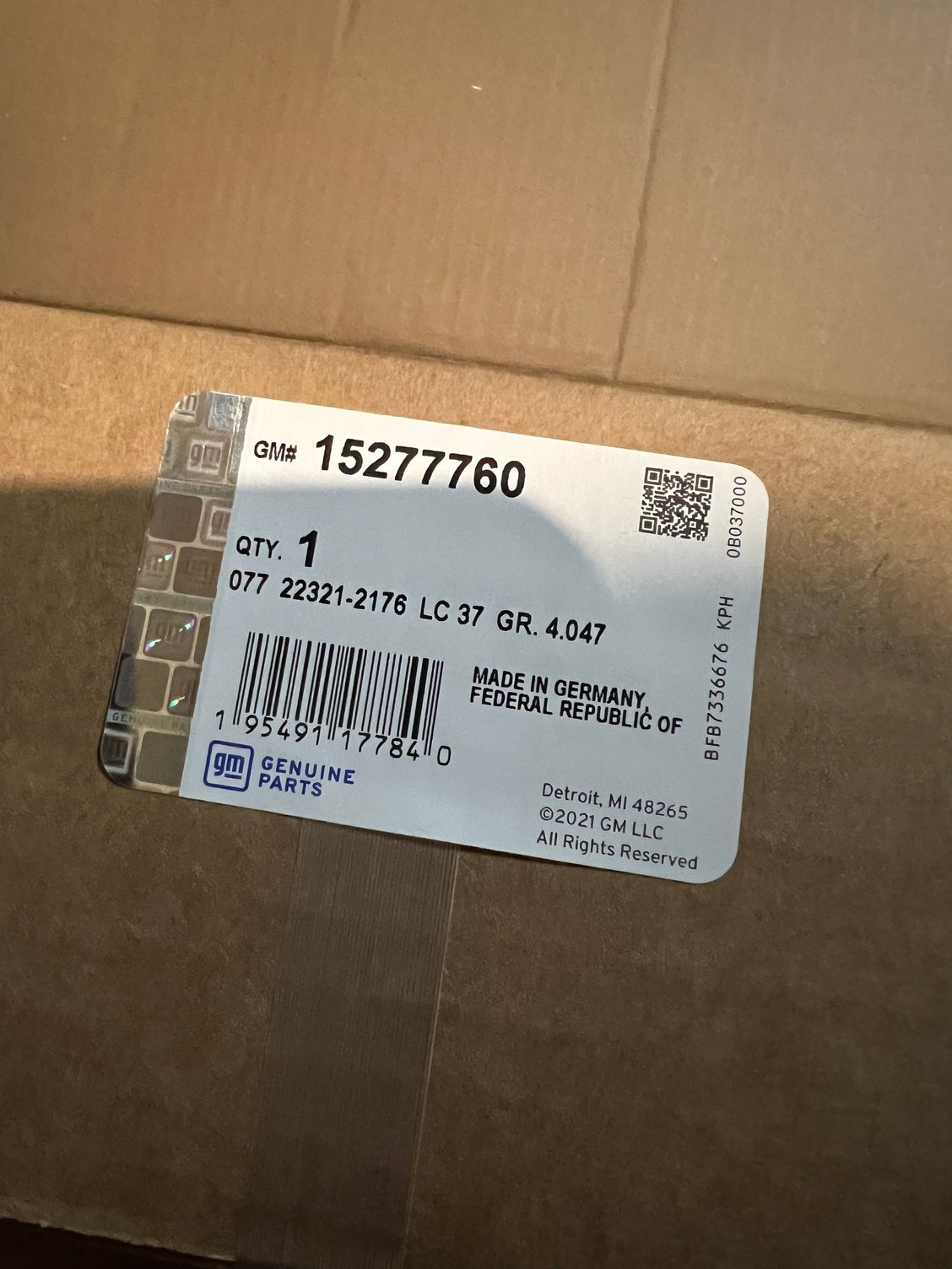

Update: Shifter cables arrived. I’ll get them installed, adjusted and be sure to share results!
