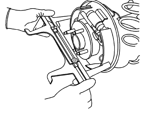

If you are asking for the absolutely correct way;
You will need a special brake caliper
measure drum diameter
set shoes to .015 inch smaller than drum

Old May 13, 2020 | 07:42 AM
