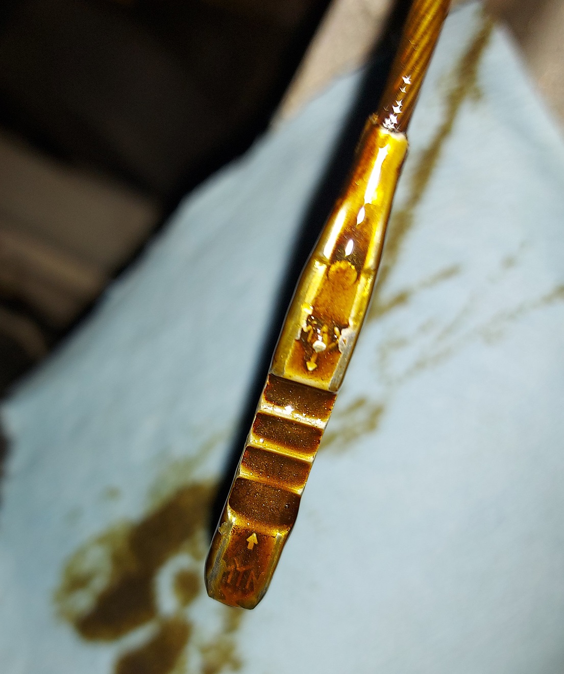

My last oil change I noticed a shine to my oil but I was too busy to be able to look into it and kind of forgot about it. Just did another oil change and It's still there and you could even see it on the dip stick before the oil was changed. No symptoms or changes in performance.. yet.
I don't know where to begin on this and because I won't be able to do any extensive repair until I have another vehicle secured I'm having to continue to drive it.
One thing I did do was run a magnet through the oil to see if it was steel or aluminium.. nothing stuck to the magnet..
Any advice or knowledge of what to expect?

As the timing chain gets loose it rubs the outside edge of the chain, you will see flat spots worn on the chain, now that would be magnetic.
Aluminium filings can also be from loose chains running , you should hear that noise.

UnknownError- Wow, that is an awful lot of non-ferrous alloy shavings on the dipstick, unless some are foaming oil ? But I use M1 one as well, & never had it foam.

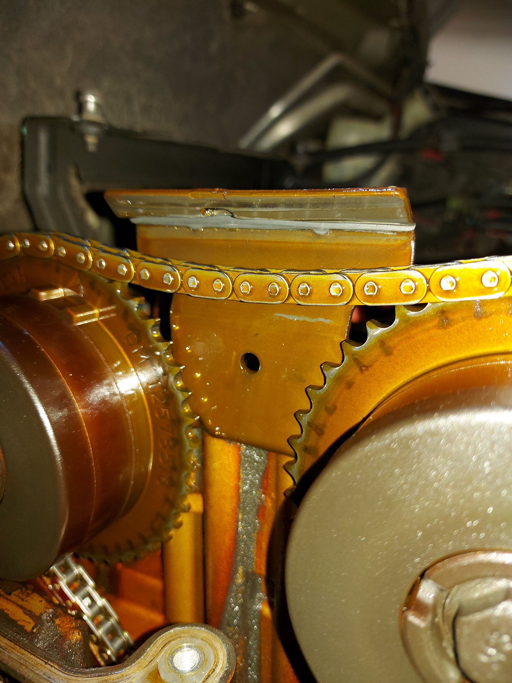

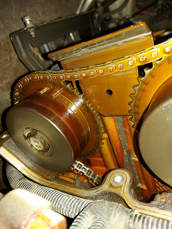

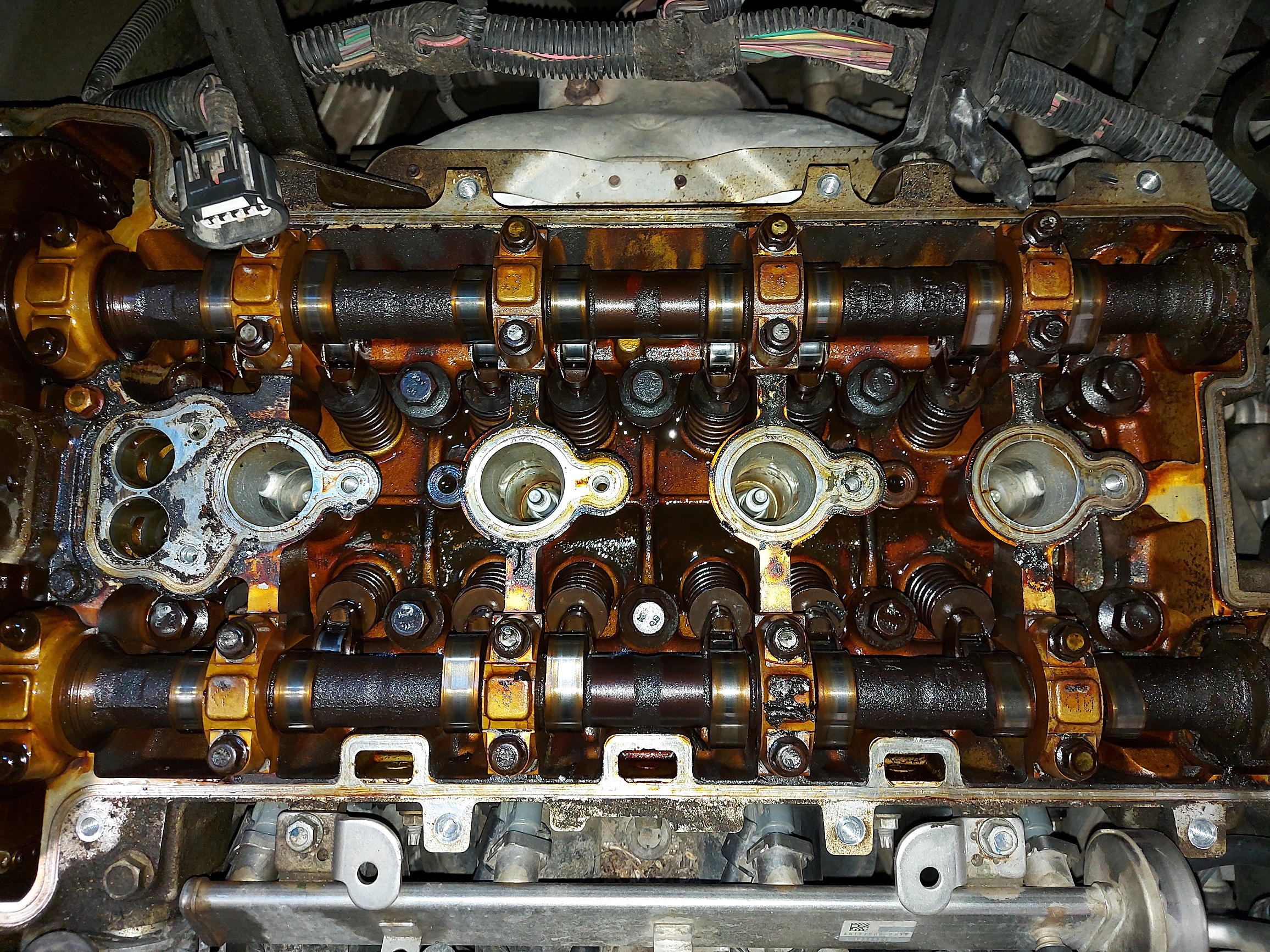

@firemangeorge Yes I did indeed change the water pump and had a whine that got a bit quieter but never went away entirely. Doing some reading and youtubing someone mentioned that it was the tensioner and it needed to be reset but because you had to open the chain cover to do so I was just going to replace the timing set anyway when I got around to it. Life happens tho and I have very limited resources and a large family in which I am the only one who works so it's hard to find time for anything.
I was able to pop the valve cover off today and took lots of pictures hoping someone would see something wrong and I found a couple problems.. The chain does sag and compared to the pic from @Oldblue, my top chain guide is bent and missing the nylon piece. (What on earth would cause it to bend like that?)
I have the CLOYES 94201SAWP and the timing chain guide bolt that I read should also be replaced in my cart. Do I need anything else?
If replacing the timing chain doesn't solve the shavings issue what else could it be?

The upper guide is so bent because the chain is so loose that the chain has been slapping the guide. You probably have the other upper guide broken or maybe the bolt for it is broken. That chain is so loose, I'm surprised that the engine isn't ruined already. You definitely should not attempt to start it again.

I know there's a lot of miles on that engine but there appears to be a lot of sludge and wear on those cam lobes.
