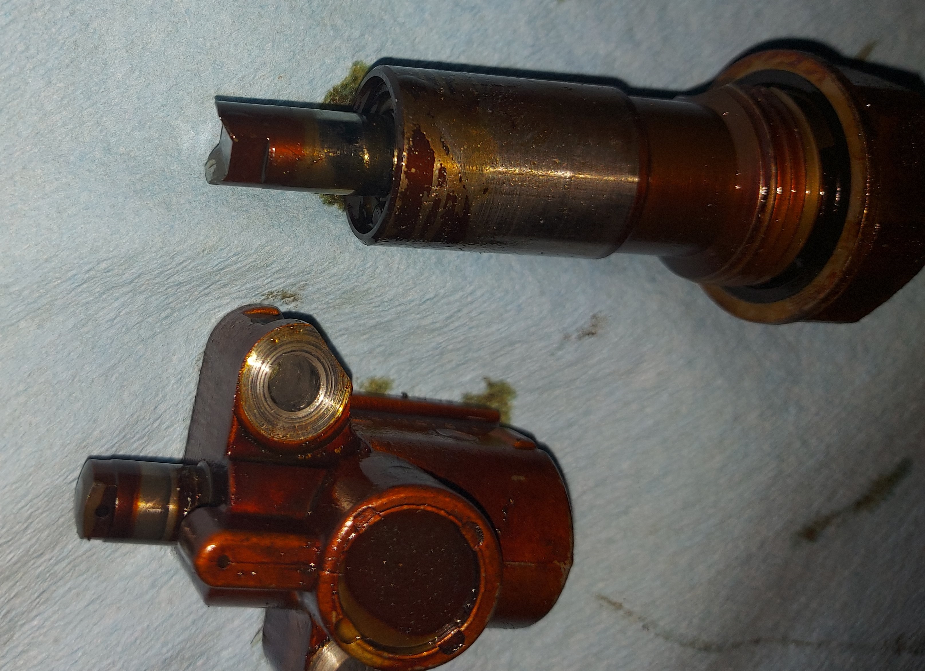

It's amazing that the bolt heads were so worn, so far from the normal path of the chain. I'm curious what the tensioner looks like. Thinking maybe the chain streched so much, then the end of the tensioner fell out of it's housing.
Old Mar 3, 2021 | 10:15 PM
UnknownError's Avatar
Joined: 10-25-2018
Posts: 130
From: Oklahoma
here ya go
Old Mar 4, 2021 | 08:04 AM
  #26
Posts: 40,096
The 22 ft/ lbs plus a further 100 degrees is for VVT engine.
