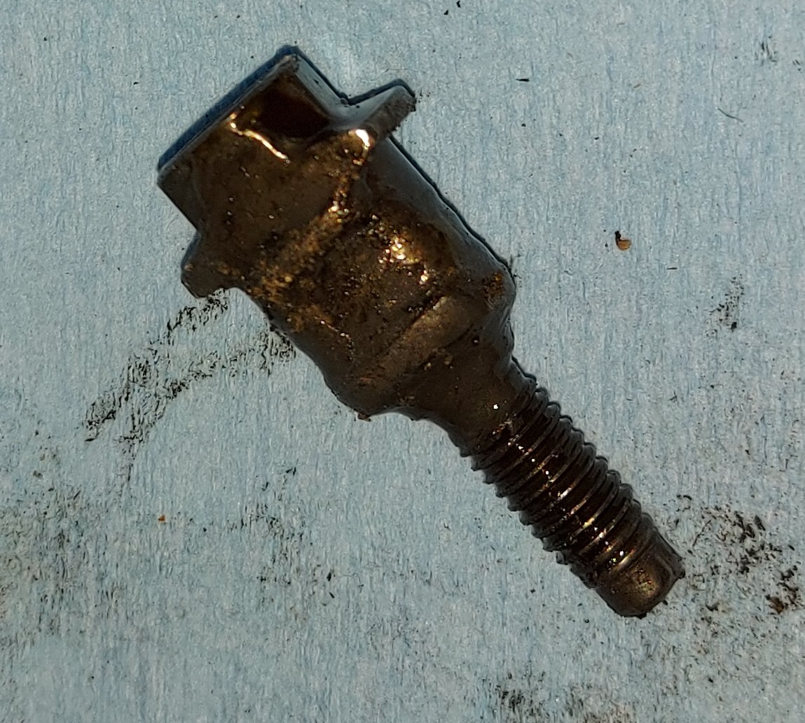

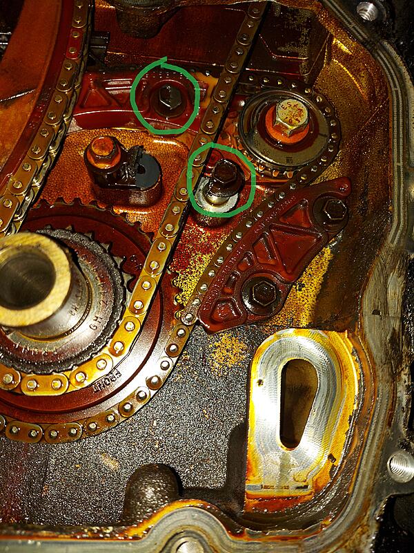

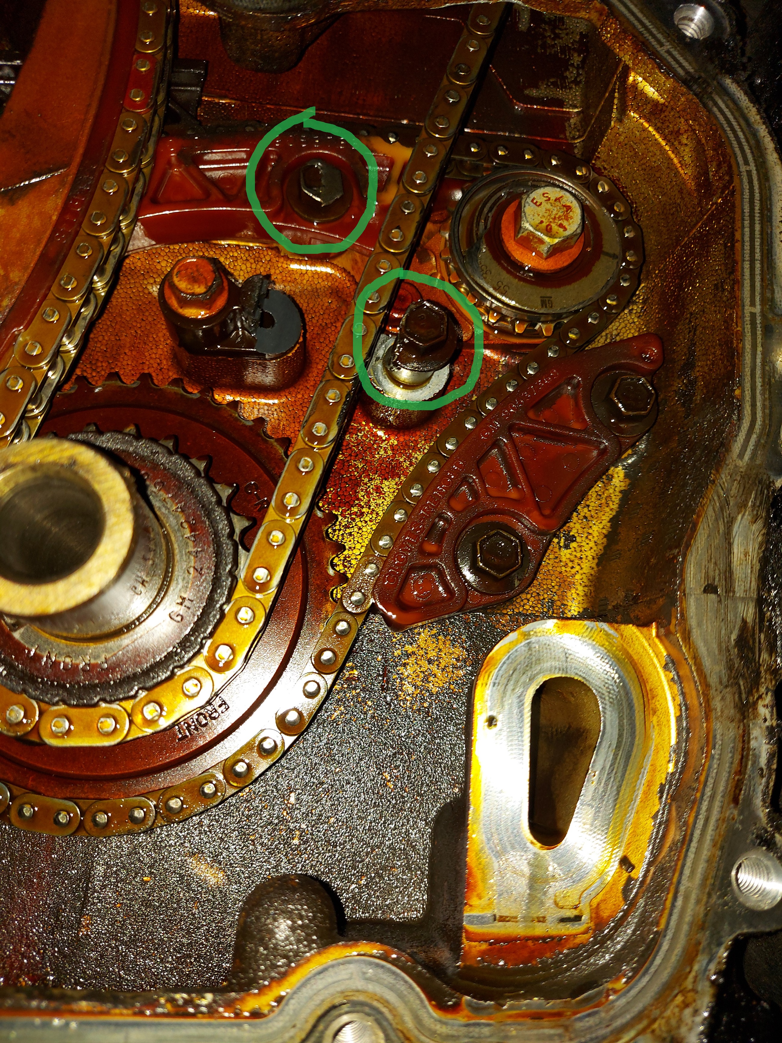

Opening the chain cover the (I'm guessing?) upper guide bolt dropped out. I already have the replacement dorman one I ordered with my chain kit. What about these other two bolts? Will I be able to reuse them or do I need to order new ones? They are chewed up pretty bad and I didn't see any bolts that came with the kit.
Also the mounting bolt that is holding the gasket (I read to cut the gasket off); do I need to remove that to install the new gasket?

Yes order new bolts the top one for the front guide should be replaced by
Dorman 917-954
the OEM bolt is what broke to damage the guide, the oiler must be replaced, it’s chewed up

I already have the dorman bolt but where do I find the other two bolts to order? do I need to get them from a stealership?

The dealership had the bolts and the part number for them is 11588522 in case anyone needs the info

ZZP, RockAuto, GM parts direct all carry them, do not over tighten them, snug , then a 1/4 turn if you don’t own a torque wrench or properly 89 inch pounds.
read thru this assembly guide
http://www.ddmworks.com/assets/image...uild%20Kit.pdf
I think you definitely found the source of the metal filings in the oil.

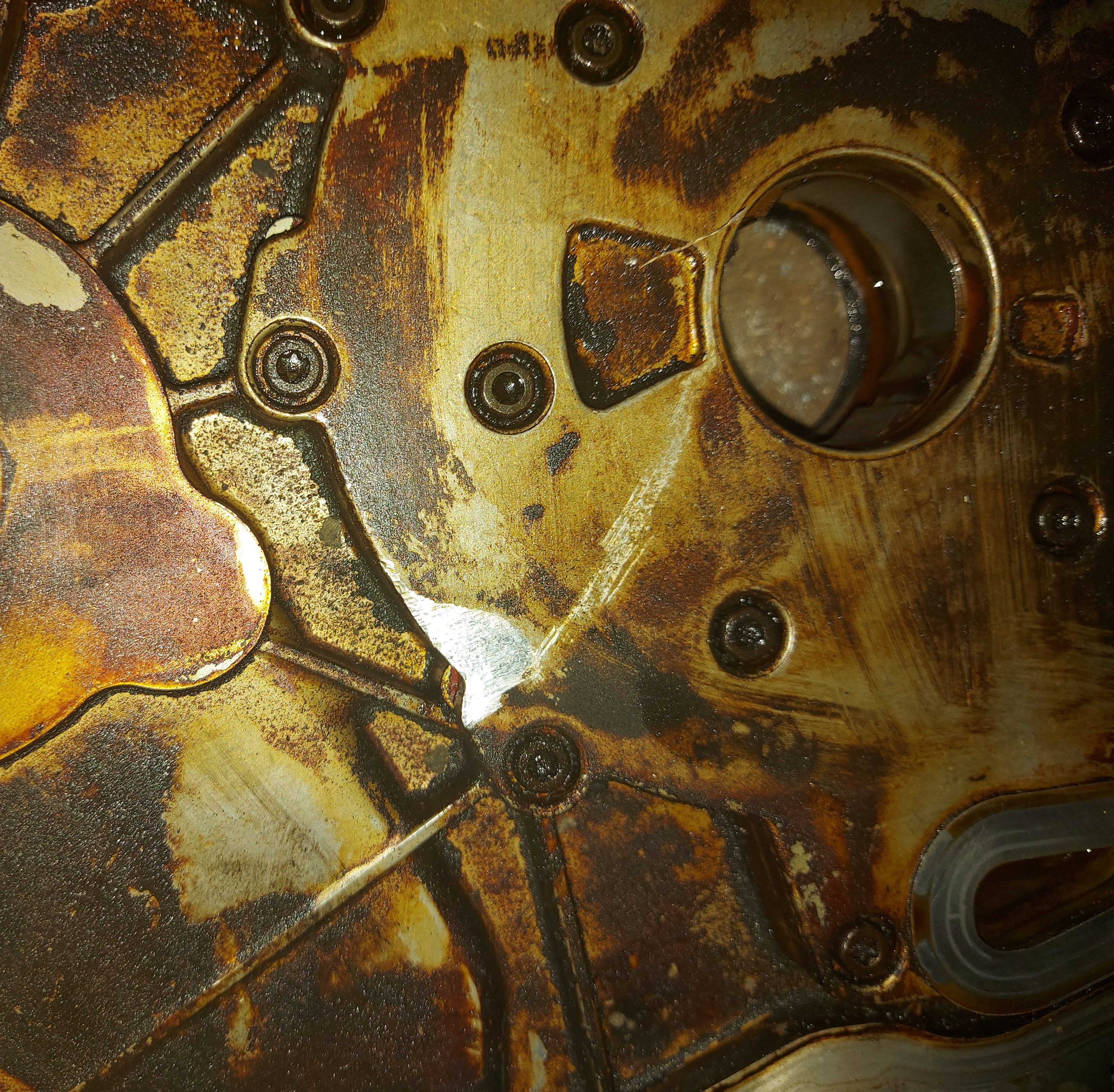

I can only assume that maybe the shavings lost their magnetism or were picked up by the magnet by the pump? I did find where the chain was rubbing the timing cover as well.
