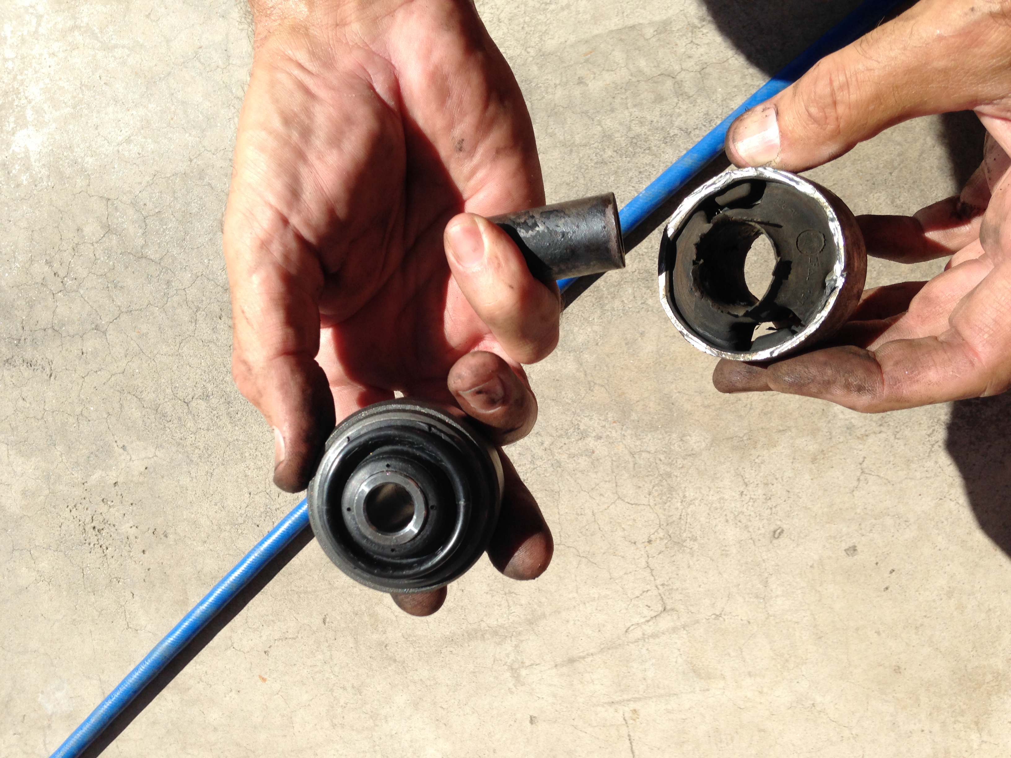

Seems like the lower control arm bushings to me. Mines went out & the best way to tell is to have the car on a lift and use a flash light to examine the bushings. The factory bushings are NOT made solid and 4 holes in them & it basically separates leaving just the center part intact.

The LCA bushing is on the right in this photo, the bushing had 70,000 miles or so.
I replaced it with Moog K200792 bushing in the left
I replaced the ball joints when I replaced the bushings at 100,000 miles
