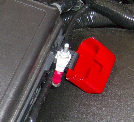

in the mean time; this is what you asked for

We've had a number of members with similar issues. It may be totally cleared, but there are some things worthy of checking. From what I remember, the typical suggestions were:
- check the battery at an auto parts store with a load tester to ensure it is up to snuff (a bad/low battery can cause some very weird issues, including bad shifting, gauges running wild etc.)
- check under the hood for loose/bad ground connections from the trans to near the radiator top support (if I remember right)
- check the under hood fuse box to ensure that the top half is secure to the lower half

First off Welcome to the site! And all the codes and things point towards the fuse box as Don mentions and a dying battery as Whopper says!
Sometimes the battery has a dead cell and can cause this problem.

And when you check the battery while your there remove the ground connection and clean the terminal and the surface it mates to then reinstall. Pull the fuse and re-seat it.
