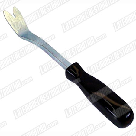

Try this thread.
https://www.chevyhhr.net/forums/how-tutorial-library-21/door-panel-removal-14040/
You'll need the tool that slides behind the clips to pop them out. The tool is well worth having so that the panel goes back on correctly.

Also, I pulled the fasteners by hand without any tool. Not a big deal really. The diagram does leave out one very important fastener which is on the trailing edge of the door about the same height as the pull handle. This one fastener is perpendicular to all the others and is a pain until you figure out it's there. I suspect other owners, especially in the snowy salty regions will be getting corrosion issues in there too eventually.
