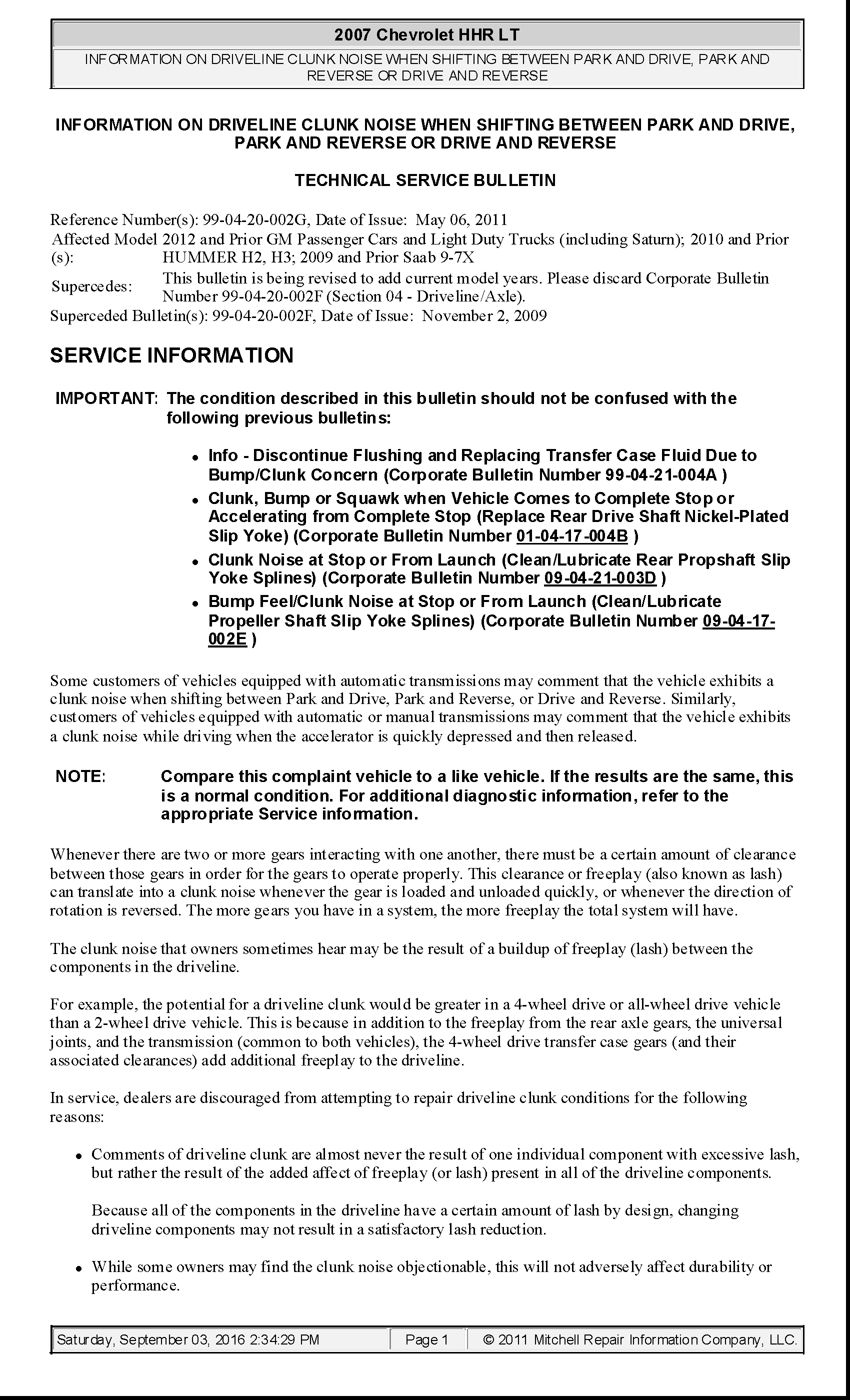

Have you looked at the pads? Sounds to me like you are describing the wear indicator screechers. If the inner pads are wearing faster than the outers, that would mean they are dragging,you may need rebuilt calipers.
Here is a TSB, I seem to remember another one concerning putting a washer on the outside end of the shaft, before the hub.

I looked at the pads not too long ago and they seemed ok and like they still had wear left in them. Probably a caliper I guess. Yeah George, I meant re surfaced and not replaced. Thanks for the TSB Don
