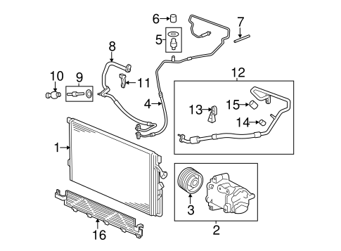

These are known for low pressure switch failure. Check the system pressure. If it's at least 40 psi, check Item 10 in this drawing.
