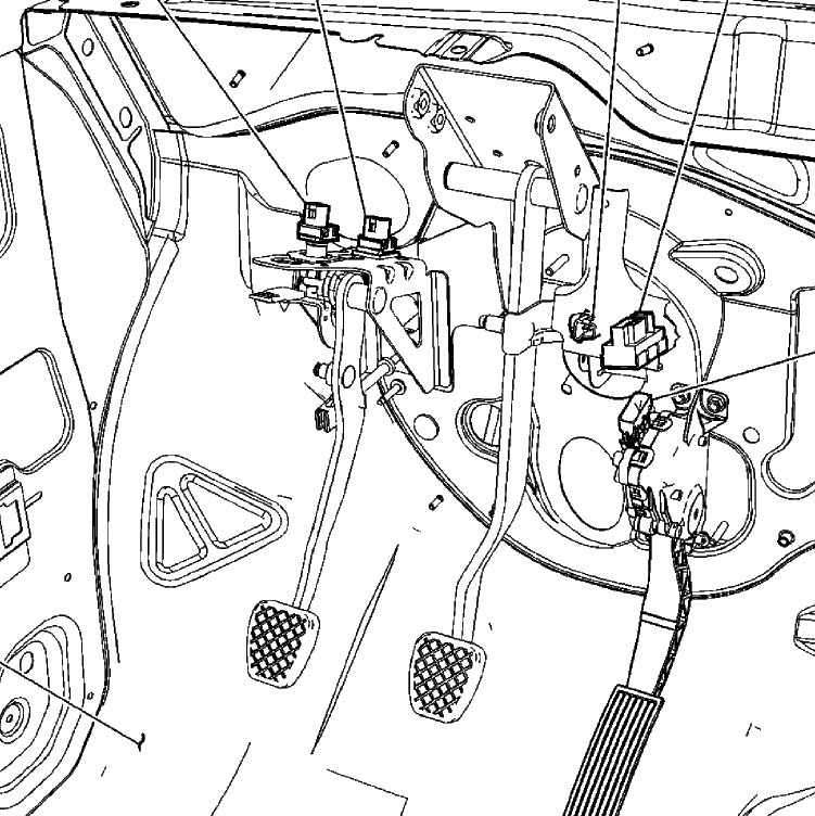

Old Aug 19, 2016 | 07:22 AM
Posts: 26,542
Passkey iii+ works differently from the previous passkey and VATS systems. Since about 2004 I think.
There is a hood ajar/closed switch on the hood latch on cars with Remote Start that prevents starting.
I think the clutch switch is under the dash on the pedal.
